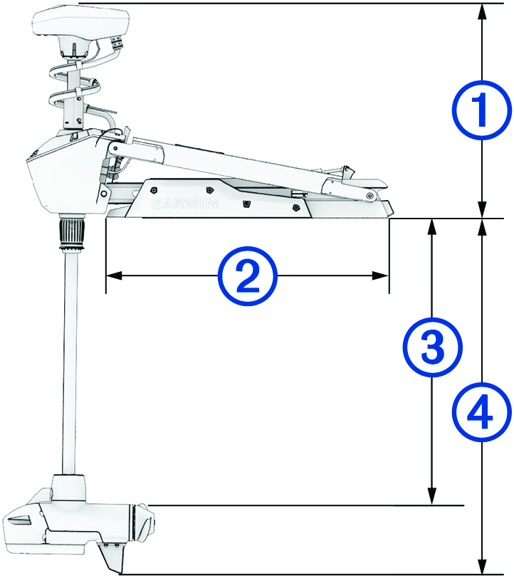

Deployed Dimensions
Device with dimension callouts
Item
50 in. Model
57 in. Model
1
496 mm (19.52 in.) min.
746 mm (29.37 in.) max.
833 mm (32.80 in.) max.
2
708 mm (27.87 in.)
799 mm (31.46 in.)
3
644 mm (25.35 in.) min.
895 mm (35.24 in.) max.
730 mm (28.74 in.) min.
1065 mm (41.93 in.) max.
4
835 mm (32.87 in.) min.
1080 mm (42.52 in.) max.
930 mm (36.61 in.) min.
1259 mm (49.57 in.) max.

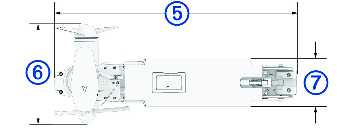

Item
50 in. Model
57 in. Model
5
931 mm (36.65 in.)
1021 mm (40.20 in.)
6
421 mm (16.57 in.)
421 mm (16.57 in.)
7
203 mm (7.99 in.)
203 mm (7.99 in.)
