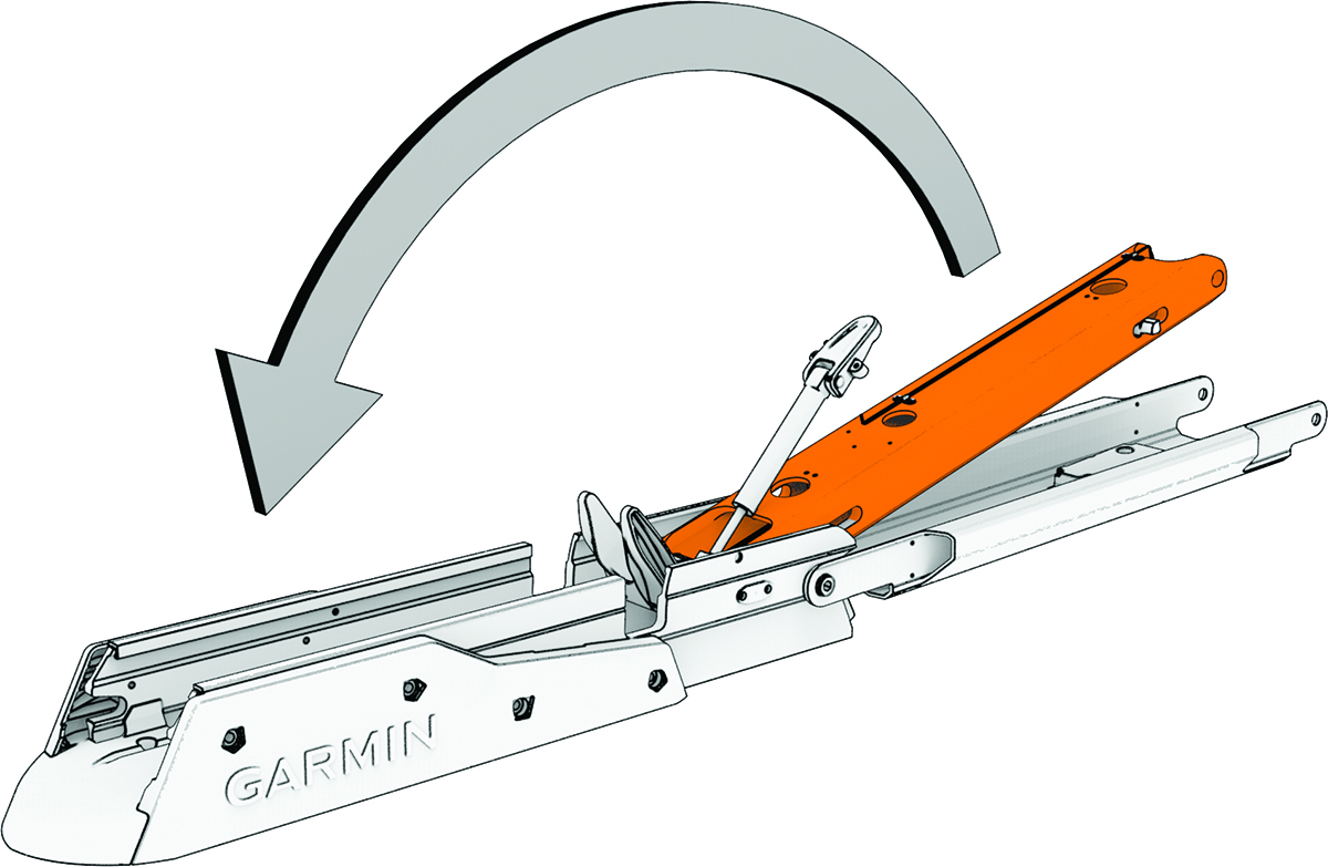

  1. Pivot the lower link of the mount forward until it locks into the base.
    Mount installation

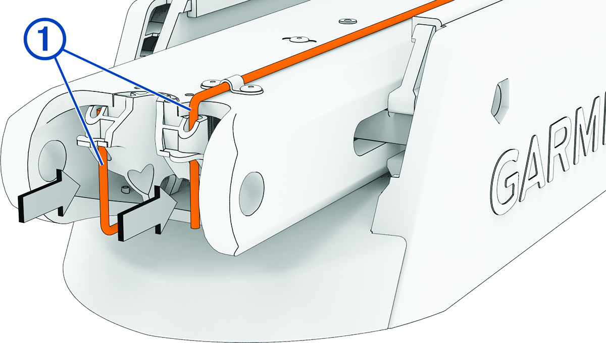

  2. Push the two safety rods 1 into the lower link as far as possible.
    Close-up view of safety rods with callout

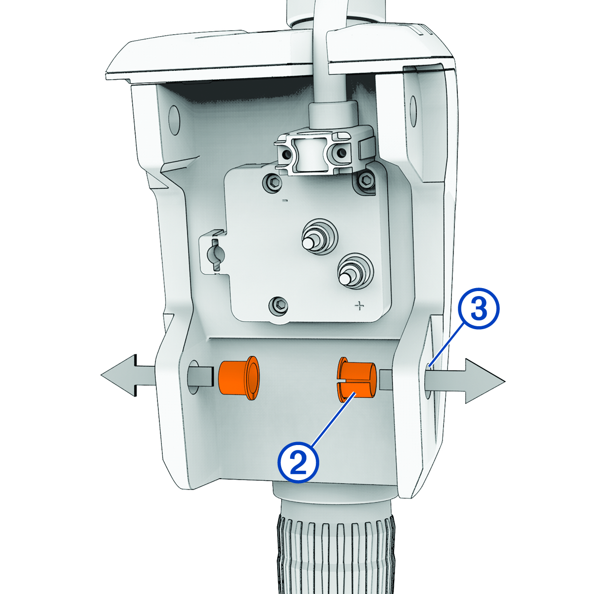

  3. Make sure that the bushings 2 are installed in the lower holes 3 on the steering system housing.
    Steering system housing and bushings with callouts
    If the bushings were removed, you can re-insert them from the inside out.

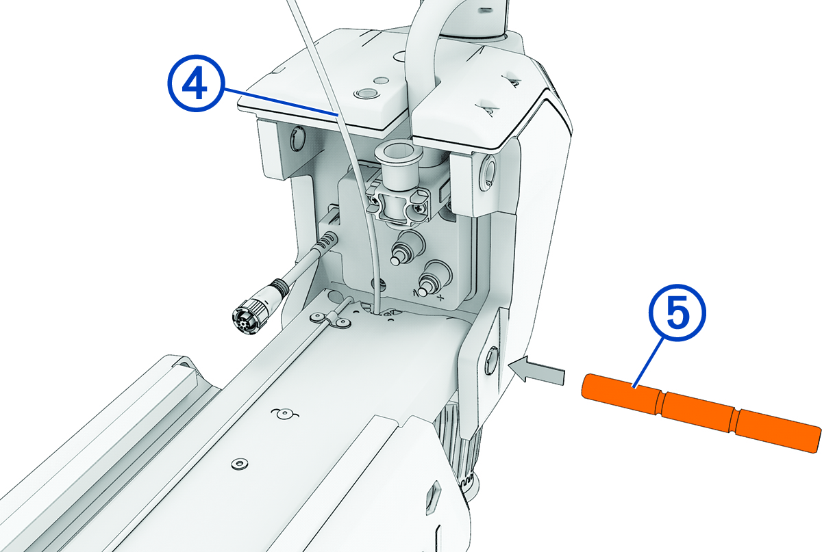

  4. Holding the pull cable 4 up, place the steering system onto the lower link of the mount, aligning the lower holes on the housing with the holes on the link.
    Steering system housing and lower pivot pin with callouts
  5. While lifting up on the steering system, push the pivot pin 5 through the housing and the link to hold it in place.
    NOTICE
    Do not hit the pin with a hammer or other object. Do not drill or modify the holes. Although it is a snug fit, the pin slides in completely when pushed by hand. Damage caused by hammering the pin or modifying the holes is not covered under warranty.

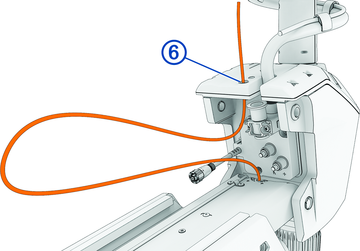

  6. Route the pull cable upward through the top of the steering system housing 6.
    Steering system housing and pull cable with callout
