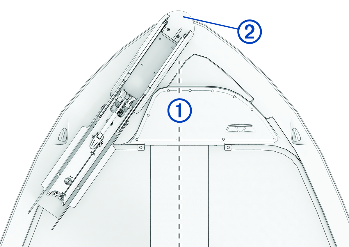

  • You must install the motor on the bow of your boat.
  • You should install the mount so the deployed motor is as close to the centerline of the boat 1 as possible.
    Device placement on boat with callout
  • You must install the mount with the bumper 2 overhanging the gunwale of the boat.
  • The motor secures to the deck of the boat using bolts, so you must have room to secure the mount from the underside using washers and nuts.
  • The motor must have clearance to move from the deployed to the stowed position and back again, so the installation location must be clear of obstacles.
  • Verify that the deck is strong enough for the weight and force of the trolling motor. Use a backing plate or reinforce the boat if needed.
