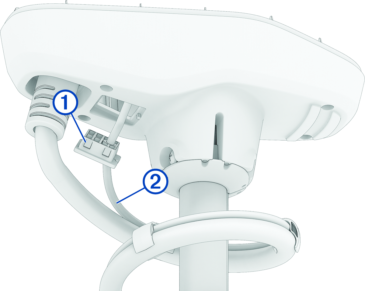

  4. Push from the inside out to remove the square grommet Callout number 1 that holds the transducer cable Callout number 2 in the shaft cap.
    Outer shaft cap cables with callouts
  5. Remove the grommet from the transducer cable.
    The grommet is split on one side to make it easy to remove from the cable.
    You should keep the grommet in a safe place, because you must reinstall it later.
  6. Feed the transducer cable through the shaft cap from the outside in until it is no longer routed through the square hole.
