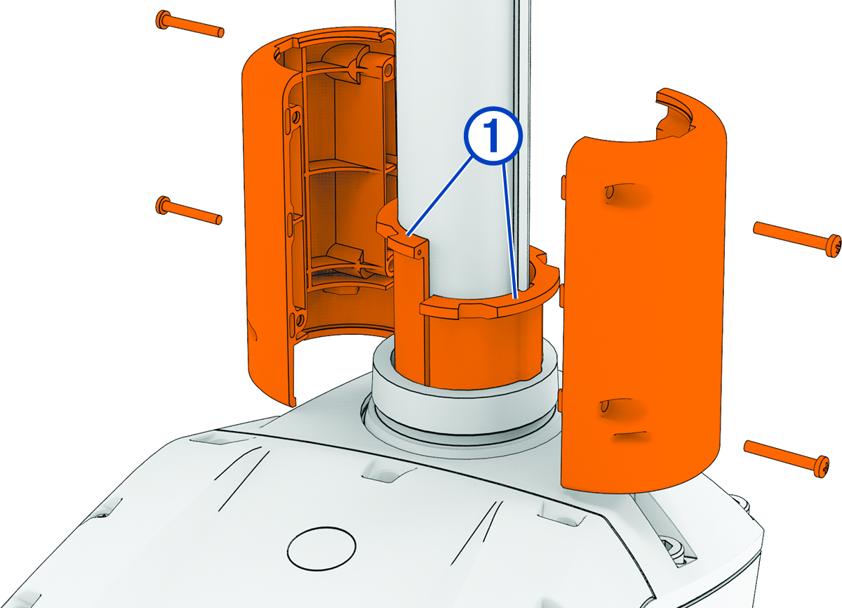

Removing the Depth Limiter Remove the screws from each half of the depth limiter, and pull the pieces away from the shaft. Lift up to remove the bushings from inside the steering system housing. Parent Topic: Removing the ShaftHomeRemoving the ShaftRemoving the Depth Limiter
