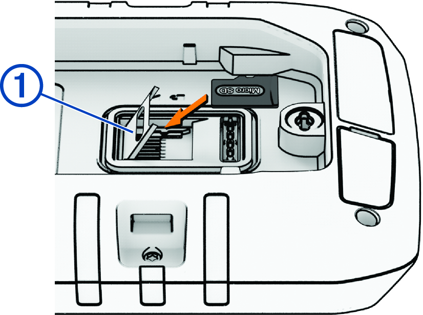

You can install a microSD® memory card, up to 32 GB, in the handheld device for additional storage or pre-loaded maps.
  1. Turn the D-ring counter-clockwise, and pull up to remove the battery pack.
  2. Slide the card holder 1 to Unlock and lift up.
  3. Place the memory card with the gold contacts facing down.
    Close-up view of the microSD card slot with a callout
  4. Close the card holder.
  5. Slide the card holder to Lock to lock it.
  6. Replace the battery pack.
