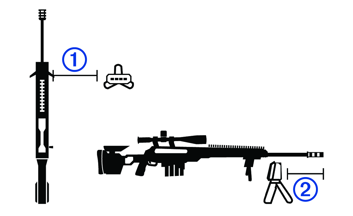

Starting a Rifle Session
NOTICE
Always ensure you position the chronograph so that it is not directly exposed to ejecting cartridge cases, muzzle blast, or other hazards that may damage the chronograph.
  1. Select NEW SESSION > RIFLE.
  2. Select a velocity range.
  3. If you have enabled the PROJECTILE WEIGHT ENTRY setting (Enabling Projectile Weight Entry), select an option:
    • To calculate the kinetic energy and power factor of your bullet, select YES, and enter the weight of your bullet.
    • To continue without calculating kinetic energy and power factor, select SKIP.
  4. If necessary, observe the alignment diagram and press OK to continue.
  5. Position the rifle next to the chronograph, within 15 to 35 cm (5 to 15 in.) of the chronograph 1, and ensure the chronograph is 15 to 35 cm (5 to 15 in.) behind the muzzle 2.
    Rifle alignment diagram with callouts
    NOTE: The chronograph can be positioned on either side of the rifle.
  6. Point the chronograph at the target with the screen facing you.
The device detects shots and displays measurements automatically as you shoot.

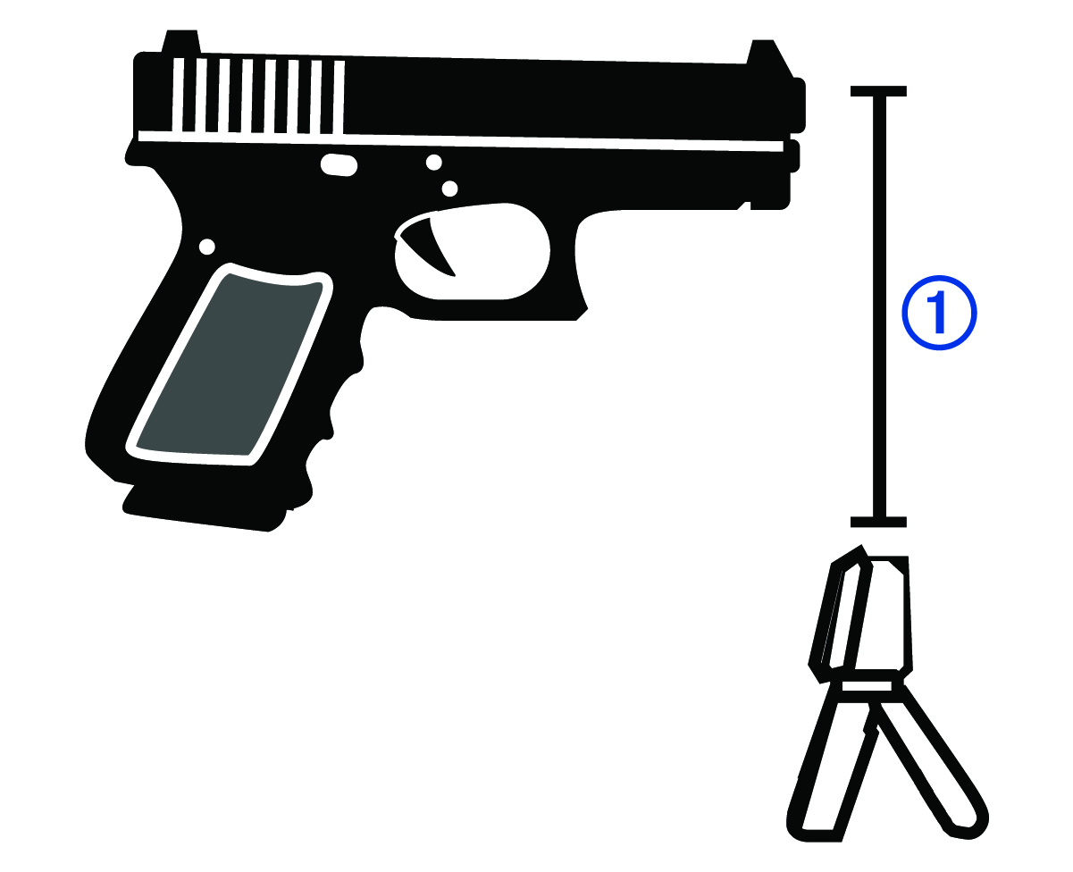

Starting a Pistol Session
NOTICE
  1. Select NEW SESSION > PISTOL.
  5. Point the chronograph at the target with the screen facing you.
  6. Hold the pistol over the chronograph so the barrel is positioned 15 to 35 cm (5 to 15 in.) above the chronograph 1.
    Pistol alignment diagram with a callout

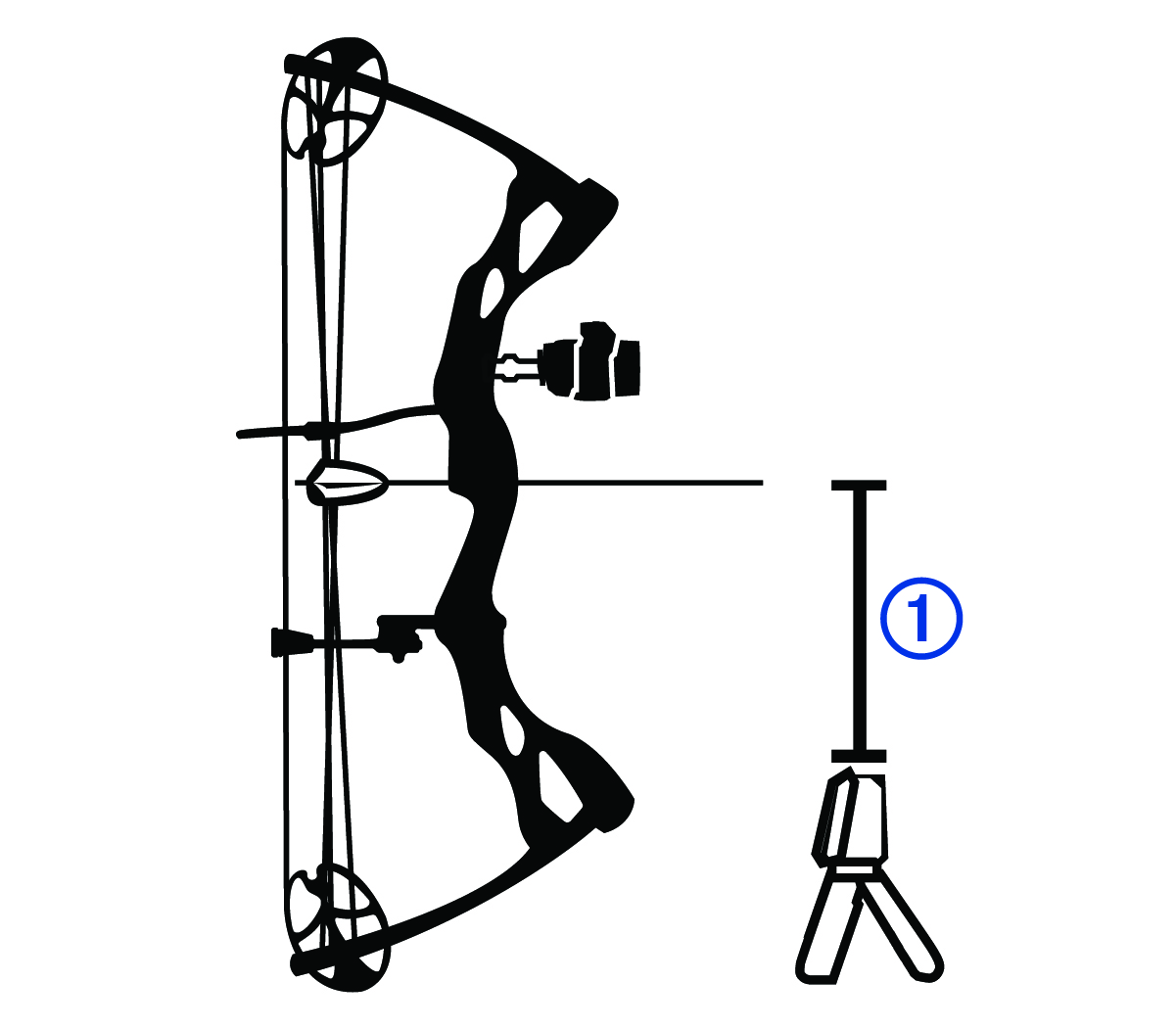

Starting a Bow Session
NOTICE
Always ensure that you position the chronograph so that it is not directly exposed to hazards that may damage the chronograph.
When you use the chronograph for archery, you should use a target that is at least 4 meters or 4 yards away from you.
  1. Select NEW SESSION > BOW.
  2. If you have enabled the PROJECTILE WEIGHT ENTRY setting (Enabling Projectile Weight Entry), select an option:
    • To calculate the kinetic energy of your arrow, select YES, and enter the weight of your arrow.
    • To continue without calculating kinetic energy, select SKIP.
  3. If necessary, observe the alignment diagram, and press OK to continue.
  4. Point the chronograph at the target with the screen facing you.
  5. Hold the bow over the chronograph so the arrow is 15 to 35 cm (5 to 15 in.) above the chronograph 1.
    Bow alignment diagram with a callout
The device detects shots and displays measurements automatically as you shoot. The measured velocity is the speed of the arrow as it passes over the chronograph.

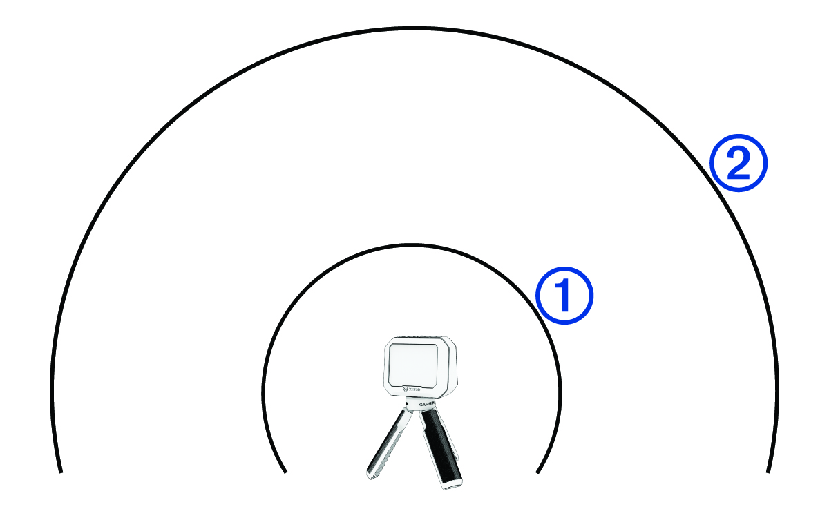

Starting a Session for Other Projectiles
NOTICE
You can use the Xero C2 chronograph to measure velocity of other projectiles that may not fit into other categories, such as some muzzleloading firearms, shotguns with slugs, slingshots, or other weapons.
  1. Select NEW SESSION > OTHER.
    • To calculate the kinetic energy of your projectile, select YES, and enter the weight of your projectile.
  5. Position the weapon next to the chronograph, within 15 cm (5 in.) 1 to 35 cm (15 in.) 2 of the chronograph.
    Alignment diagram with callouts
    NOTE: The weapon can be positioned at any point around the chronograph as long as the weapon and chronograph are positioned 15 to 35 cm (5 to 15 in.) away from each other. You should choose a location that works best for your weapon.
