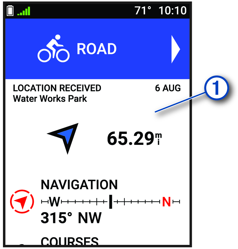

  1. Select the shared location information from the dynamic area on the home screen 1.
    Home screen with location

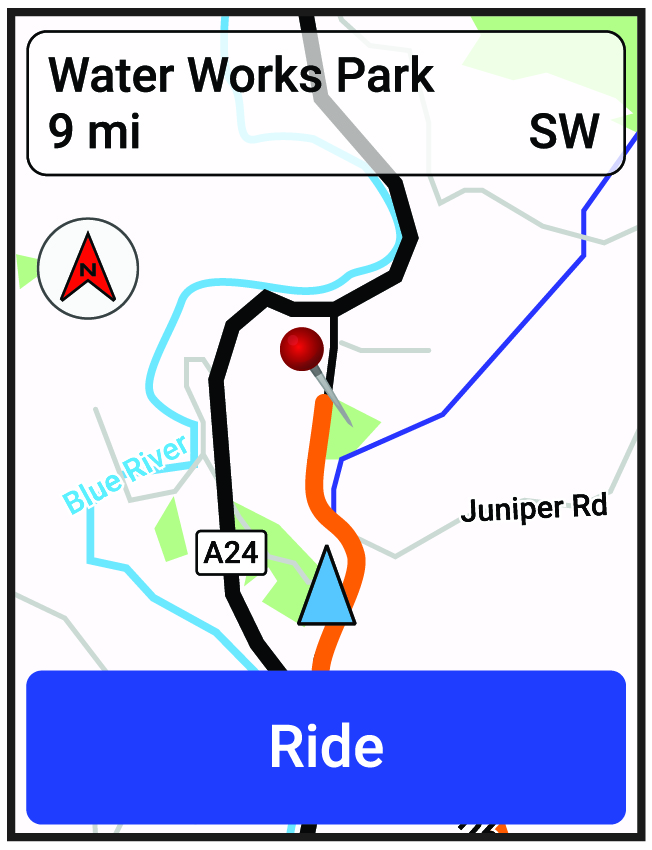

    Your Edge bike computer displays a map with the shared location name and its coordinates.
    TIP: The location is saved in the Navigation > Recent Finds menu.
  2. Select Ride.
    Map data
  3. Follow the on-screen instructions to proceed to your destination.
