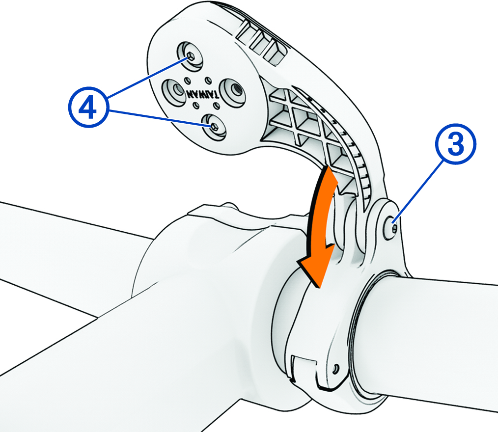

  5. Use the 3 mm hex key to loosen the screw 3 on the mount arm, position the mount arm, and tighten the screw.
    NOTE: Garmin® recommends tightening the screw so the mount arm is secure, with a maximum torque specification of 20 lbf-in. (2.26 N-m). You should check the tightness of the screw periodically.
    Mountain bike mount with callouts
  6. If necessary, use the 2 mm hex key to remove the two screws on the back side of the mount 4, remove and rotate the connector, and replace the screws to change the orientation of the mount.
