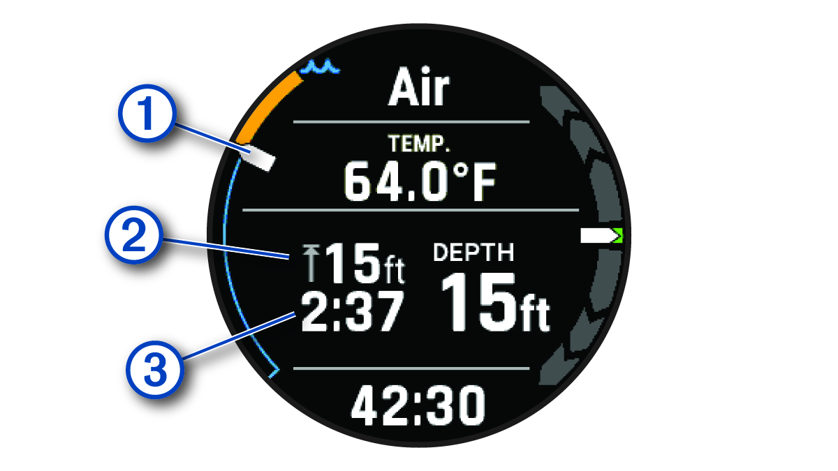

    Safety stop information appears on the data screens.
    Safety stop data with callouts
    Callout number 1
    Your depth relative to the surface.
    As you ascend, your position moves upward toward the safety stop depth.
    Callout number 2
    The safety stop ceiling depth.
    Callout number 3
    The safety stop timer.
    When you are within 1 m (5 ft.) of the ceiling depth, the timer starts counting down.
