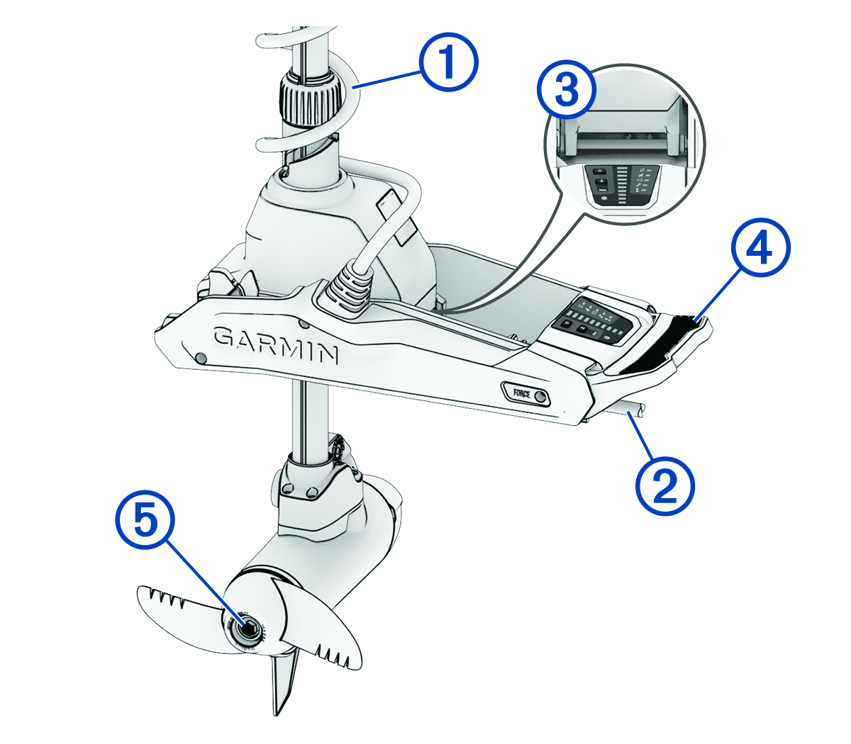

Device overview with callouts
  • Examine the coil cable 1 for wear, and replace it as necessary.
  • Check and clean the power cables 2.
  • Lubricate the hinge 3 with marine grade grease.
  • Clean and lubricate the stow and deploy latch pedal 4 and latch bar.
  • Clean or replace the anodes 5 in the propeller drive motor.
  • Remove entangled fishing line and other obstructions from the propeller.
