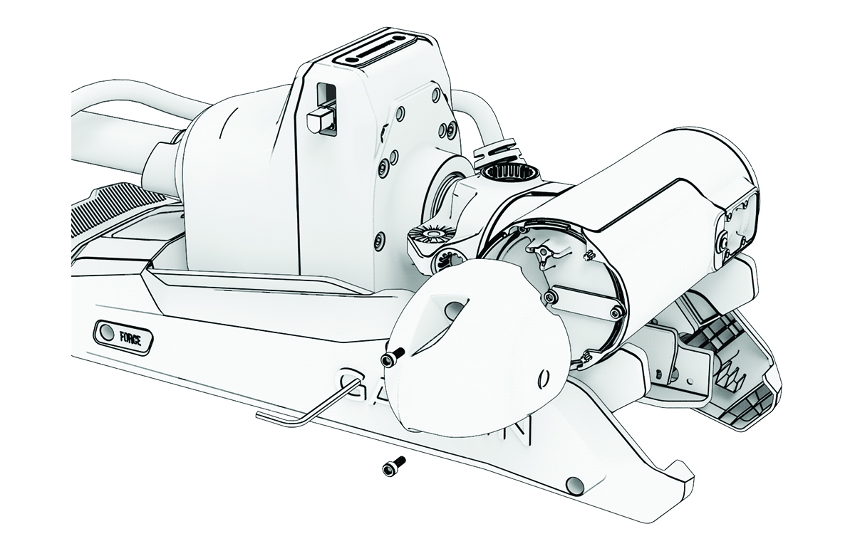

Installing the Nose Cone
NOTE: Some Force® Kraken trolling motor models are packaged fully assembled and don't require this procedure.
Using a 4 mm hex bit or wrench, secure the nose cone to the front of the propeller drive motor using the two included screws, ensuring the tab is on the bottom.
nosecone assembly diagram
