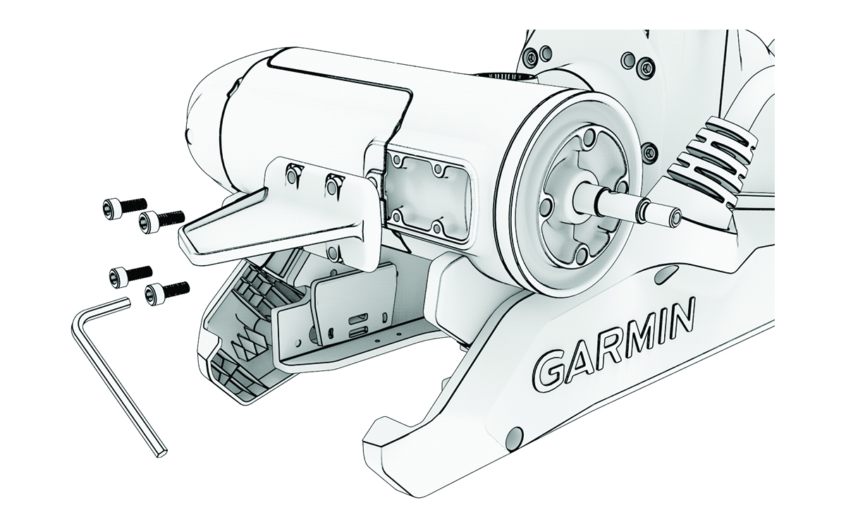

Using a 4 mm hex bit or wrench, secure the skeg to the propeller drive motor using the four included screws, ensuring the longer end of the skeg faces the propeller side.
skeg assembly diagram
