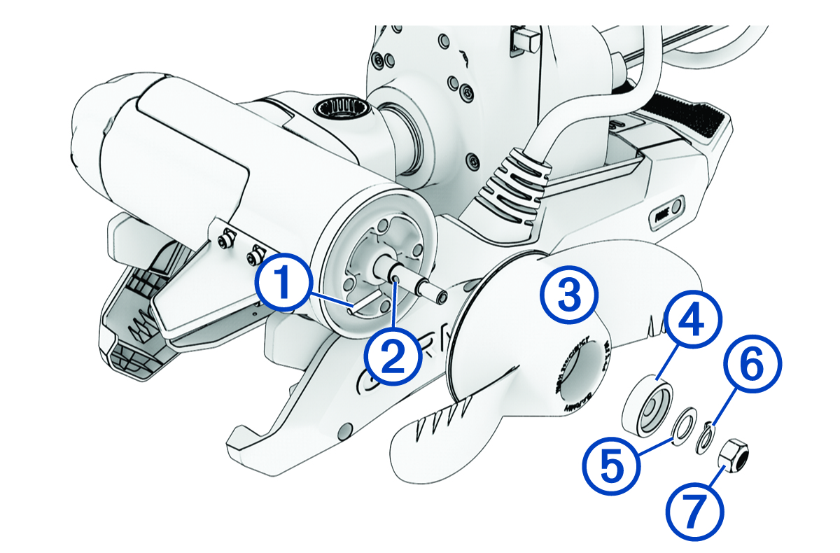

Installing the Propeller
  1. Insert the pin 1 through the propeller motor shaft 2.
    Exploded view of propeller assembly with callouts
  2. If necessary, rotate the motor shaft to orient the pin horizontally so it is less likely to fall out during installation.
  3. Align the channel on the inside of the propeller 3 with the pin, and slide the propeller onto the motor shaft.
  4. Place the anode 4, washer 5, lock washer 6, and nut 7 onto the end of the motor shaft.
  5. Using a 9/16 in. (14 mm) socket, tighten the lock nut to 16.27 N-m (12  lbf-ft) to secure the propeller.
