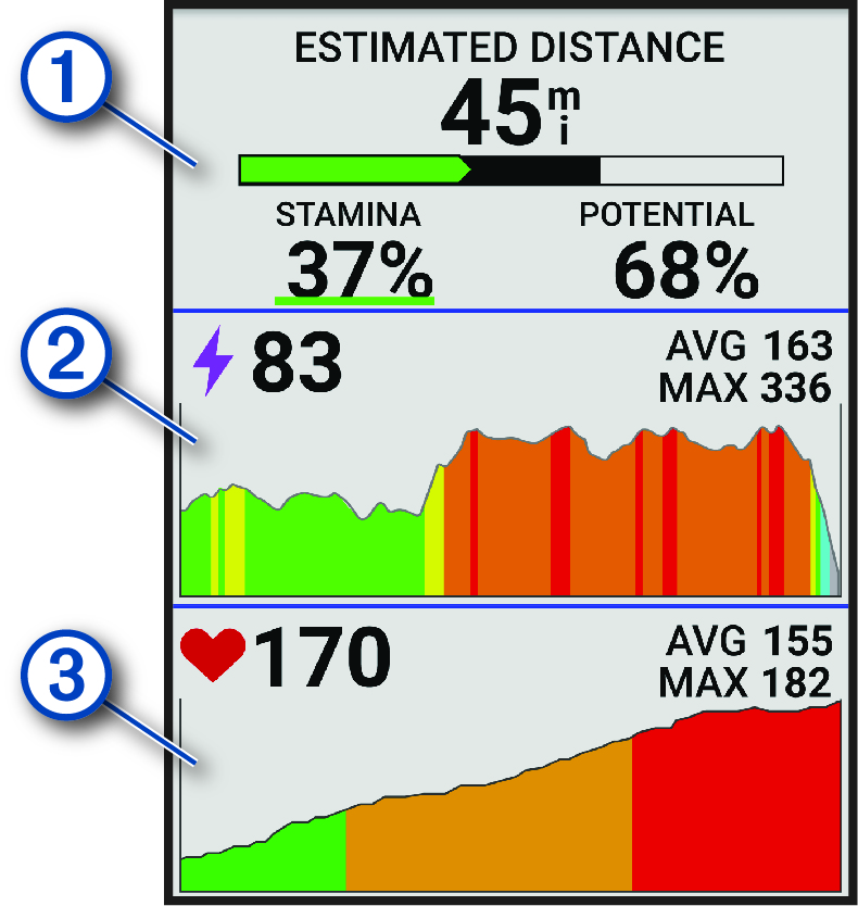

  11. Swipe left or right to view the data screen.

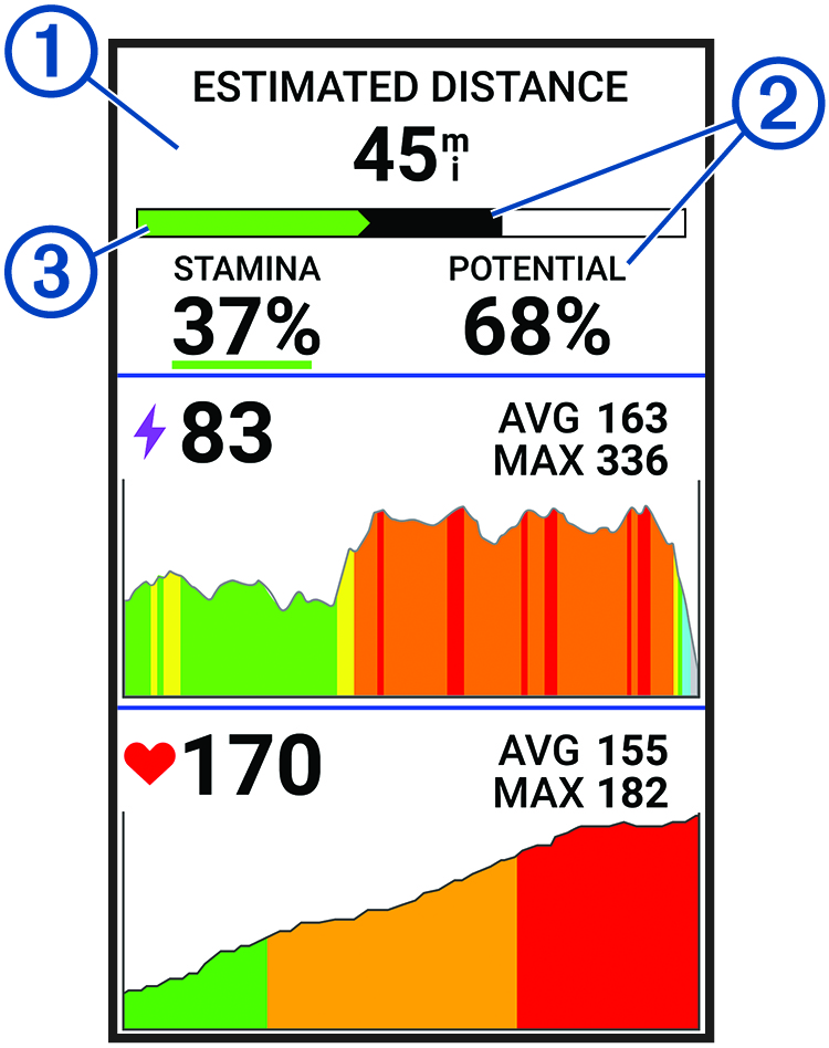

Primary stamina data field. You can view the estimated time or distance remaining until you will reach exhaustion at your current effort level.
Potential stamina estimate. Think of potential stamina as the total capacity of your fuel tank. It will decrease quickly if you are riding at a high effort level. Reducing your effort or resting results in a slower decline of your potential stamina.
Current stamina estimate. Your current stamina reflects how much you have left in the tank at your current level of effort. This estimate combines general fatigue with anaerobic cycling activities, such as sprints, climbs, and attacks.
Red: Stamina is depleting.
Orange: Stamina is steady.
Green: Stamina is recharging.
