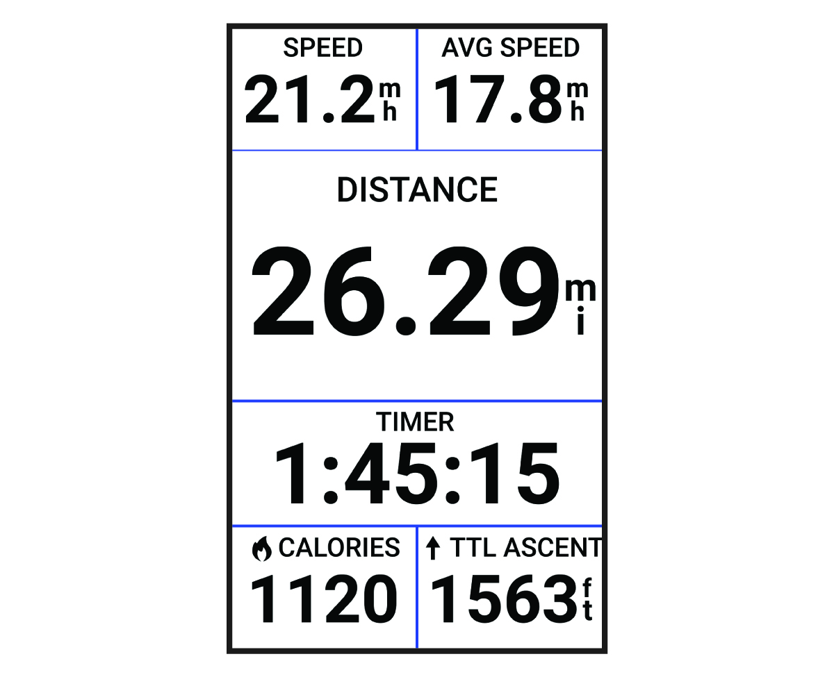

  1. Swipe left or right to view additional data screens.
You can swipe down from the top of the data screens to view the widgets.
