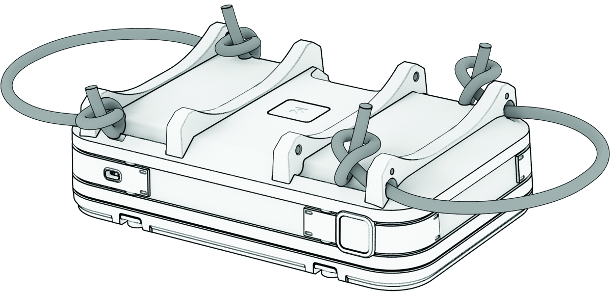

The dive computer is compatible with 3 mm (1/8 in.) bungee cords (not included).
  1. Remove the existing bands from the dive computer (Changing the Bands).
  2. Cut a piece of bungee cord that is long enough to wrap around your wrist, plus approximately 5 cm (2 in.) to allow for tying the knots.
  3. Thread the cord through the outside of one of the large holes in the dive computer's lug.
  1. Tie an overhand knot, and tighten the knot by applying tension to both ends.
The finished knot should prevent the cord from slipping through the hole.
TIP: If preferred, you can tie a figure eight knot instead.
  1. Route the remaining end of the band through the large hole at the opposite end of the lug.
  2. Hold the cord to your wrist, examine the fit, and determine where to tie the second knot.
  3. Repeat steps 2 through 6 for the second bungee cord.

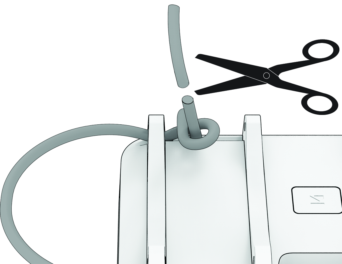

  4. Cut off the excess cord, and leave at least 6 mm (0.25 in.) at the end of each knot.
