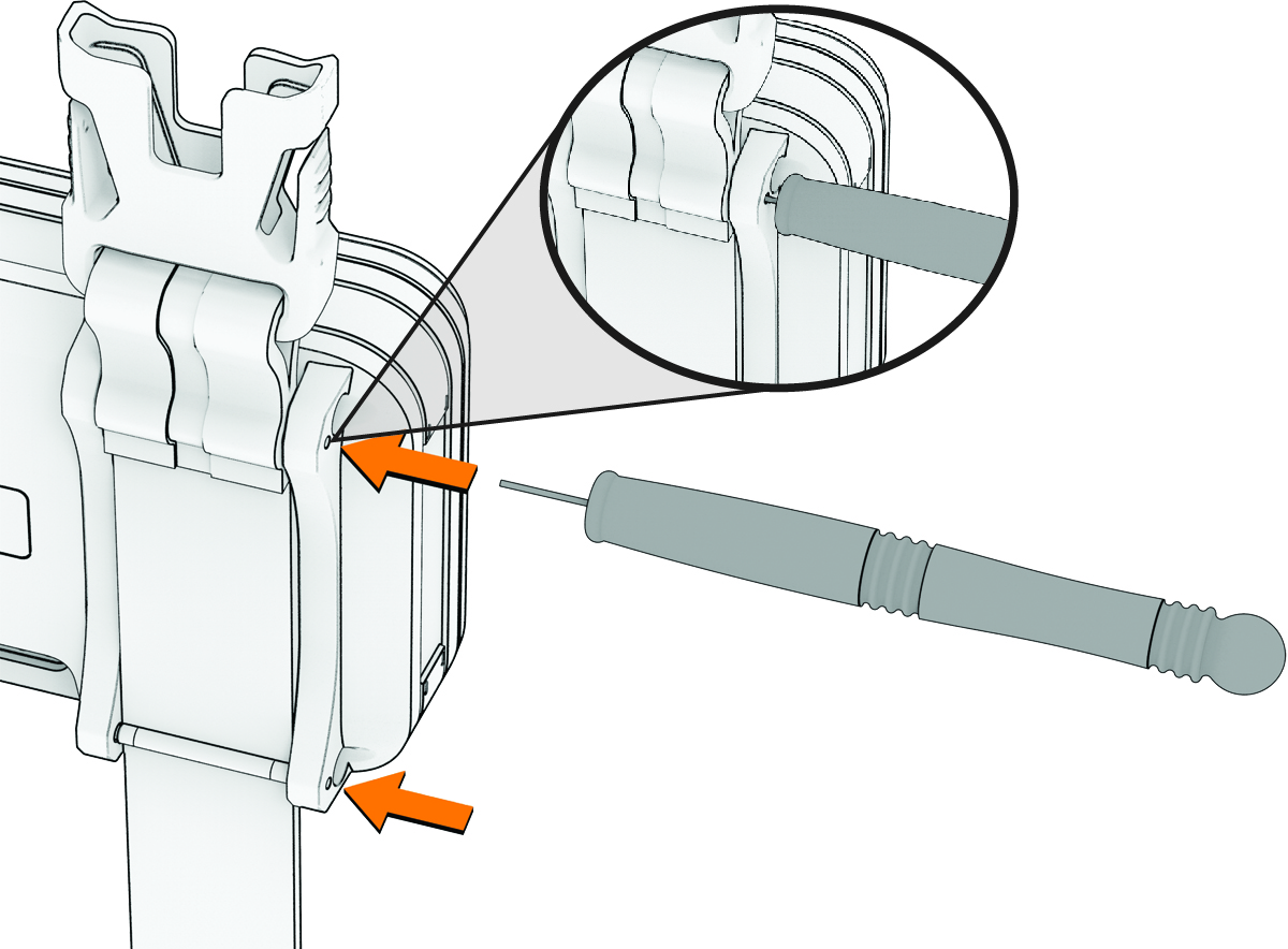

  1. Use the included pin removal tool to push in the pin on one of the bands, and remove the pin.
  1. Repeat step 1 on the second pin.
  2. Remove the band.

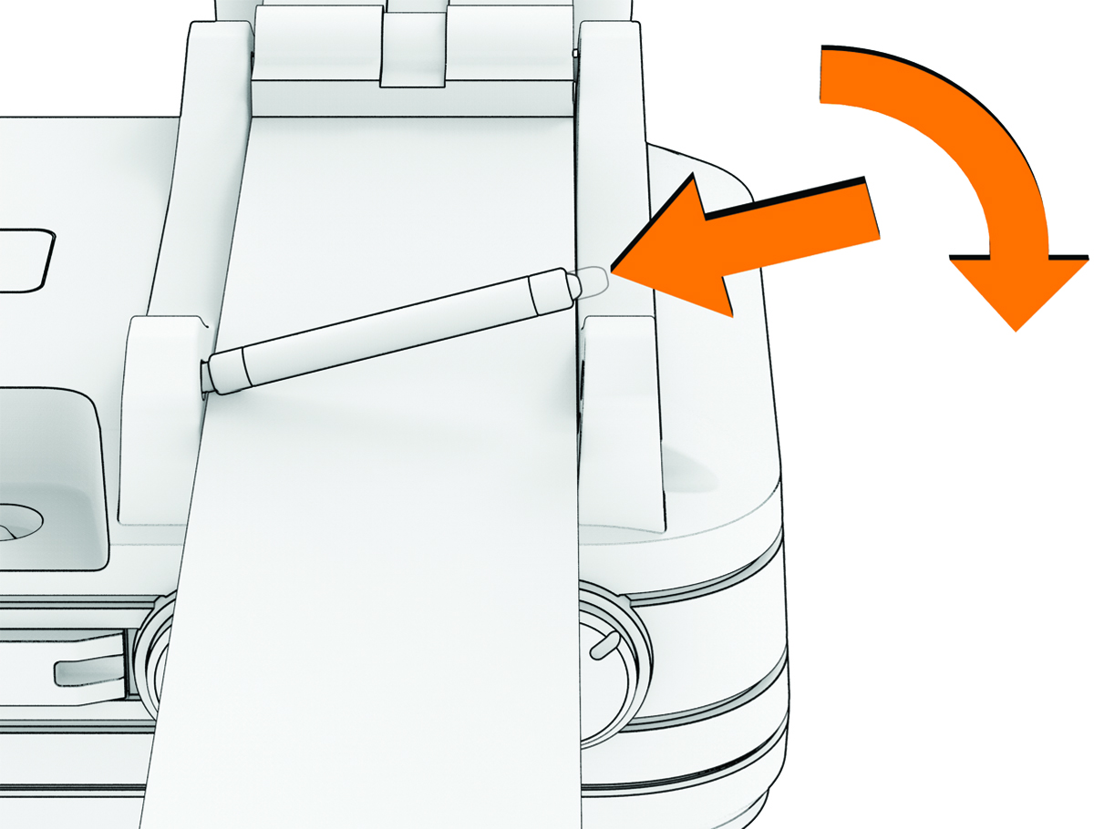

  3. Insert a pin through the loop on the new band.
  4. Install one end of the pin into the corresponding hole on the dive computer.
  5. Push in the exposed pin, and press it into place.
  6. Install the second pin above the band.
  1. Repeat the steps to change the other band.
