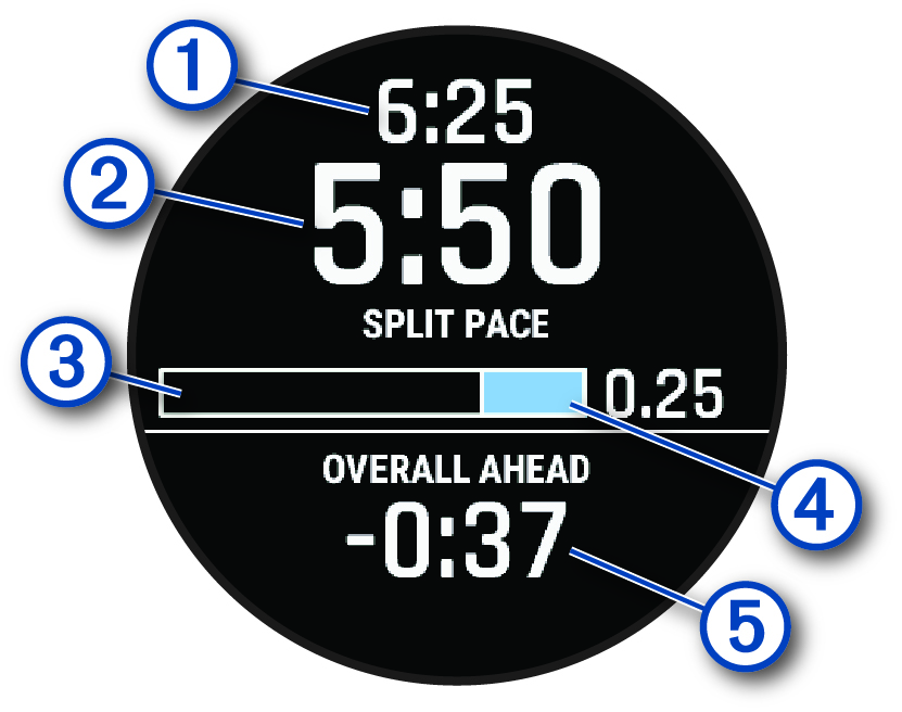

Target split pace |
Current split pace |
Completion progress for the split |
Distance remaining in the split |
Overall time ahead of or behind your target time |
