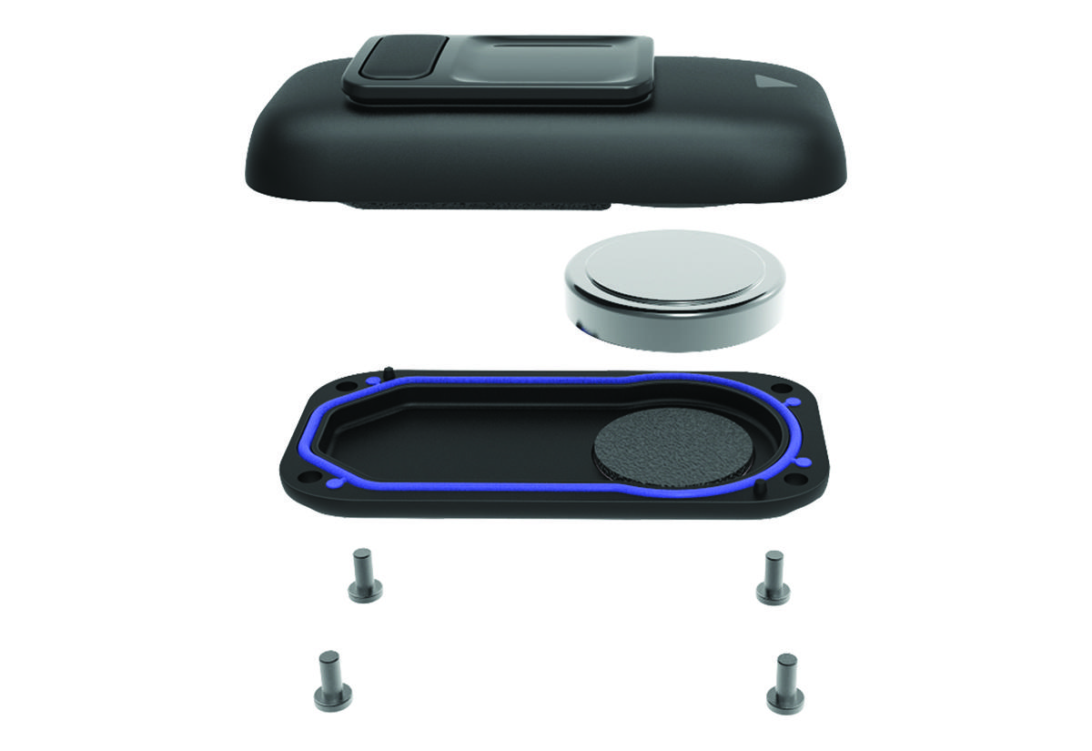

  2. Use a small Phillips screwdriver to remove the four screws on the back of the device.
  3. Remove the rear case and battery.
    Device exploded view
  4. Insert the new battery with the negative side facing the inside of the front cover.
  5. Verify the gasket is not damaged and that it is fully seated in the rear case.
  6. Replace the rear case and the four screws.
  7. Tighten the four screws equally and firmly.
