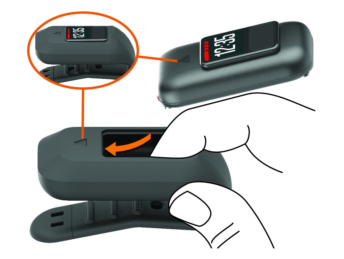

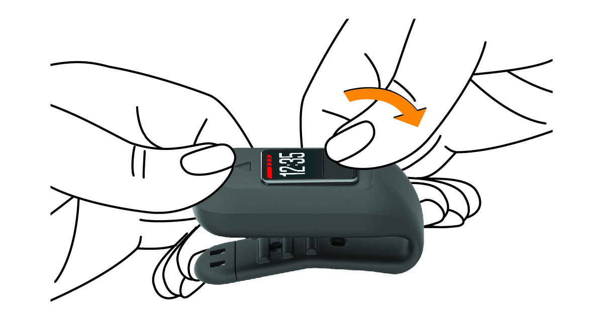

Installing the Device in the Belt Clip
Do not attach the belt clip to objects thicker than 6 mm.
You can use the optional belt clip to attach the device to your waistband, belt, or shirt pocket. Go to buy.garmin.com, or contact your Garmin® dealer for information about optional accessories.
To remove the device from the belt clip, pull the flexible clip material away from the device.
