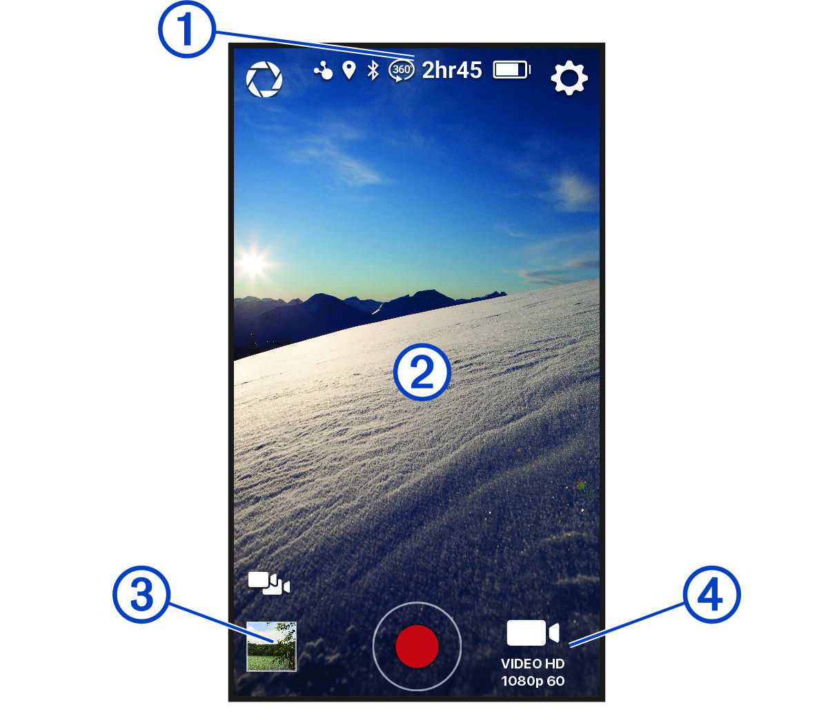

Remote Viewfinder
The remote viewfinder appears in the Garmin® VIRB® app while the app is connected to your camera.
Select to enable or change the pro settings (Pro Settings). |
Displays the sensor status, shooting mode, remaining memory card storage, and battery charge level. |
Select to change the camera settings (App and Camera Settings). |
When you are using the 360 lens mode, swipe left, right, up, or down to view a different part of the 360-degree video sphere. Tap to show or hide menu icons. |
Select to switch between multiple connected cameras (Switching Cameras). |
Select to view or share recorded videos and photos (Garmin VIRB App Gallery). |
Select to start recording a video or to take a photo. |
Select to change the video or photo shooting mode (Recording a Video Using the Garmin VIRB App). |
