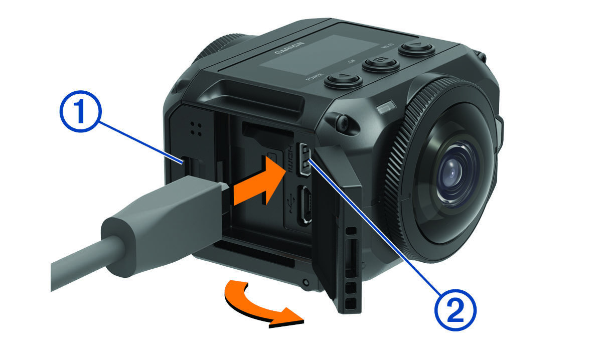

  1. Slide the latch Callout number one to open the side door.
    HDMI cable insertion into camera with arrows and callouts
  2. Plug the cable into the VIDEO port Callout number two on the camera.
    NOTE: You cannot connect a power cable and a video cable at the same time. To provide external power while outputting video, you can use an optional powered mount accessory. Go to garmin.com/virb to purchase accessories.
  3. Plug the other end of the cable into your external device.
