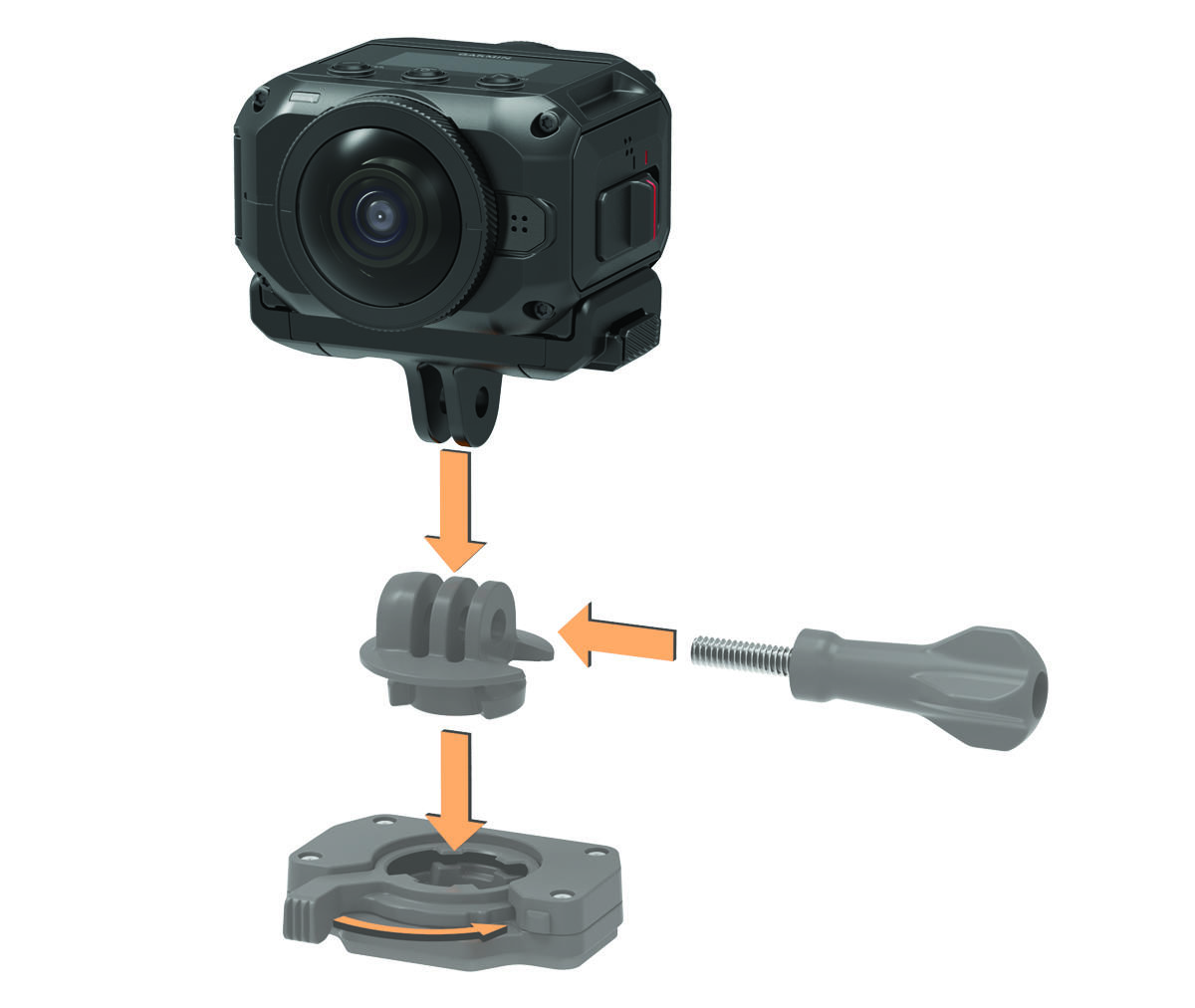

  1. Place one side of the camera into the cradle, fitting the grooves in the side of the camera onto the teeth.
    Camera insertion into cradle with arrow
  2. Press the other side of the camera down until it clicks.
  3. Place the flanges on the bottom of the action cradle into the compatible mount (not included), and secure the cradle with a thumbscrew.
    Camera with cradle insertion onto mount with arrows
    NOTE: Some mounting accessories may use a different method to secure the camera to the mount. See the instructions included with the mounting accessory for more information.
