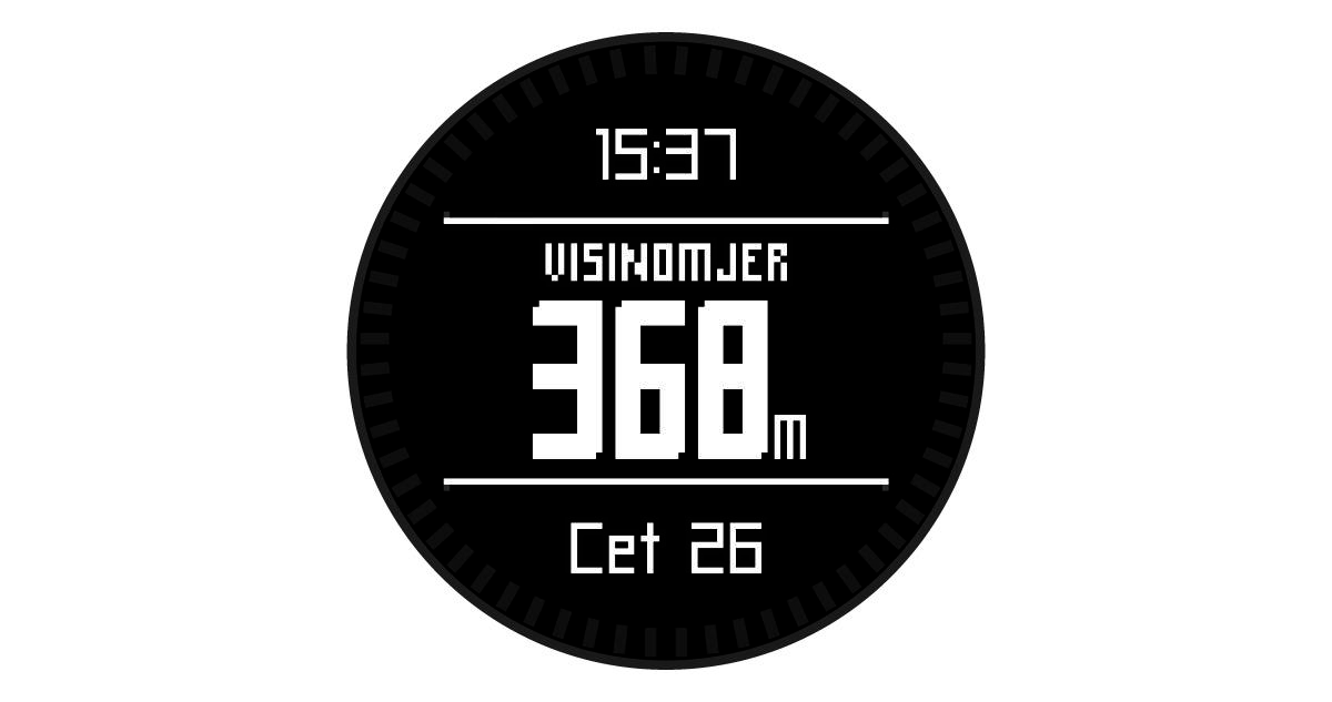

  2. Odaberite Down arrow.
    Screenshot of the altimeter

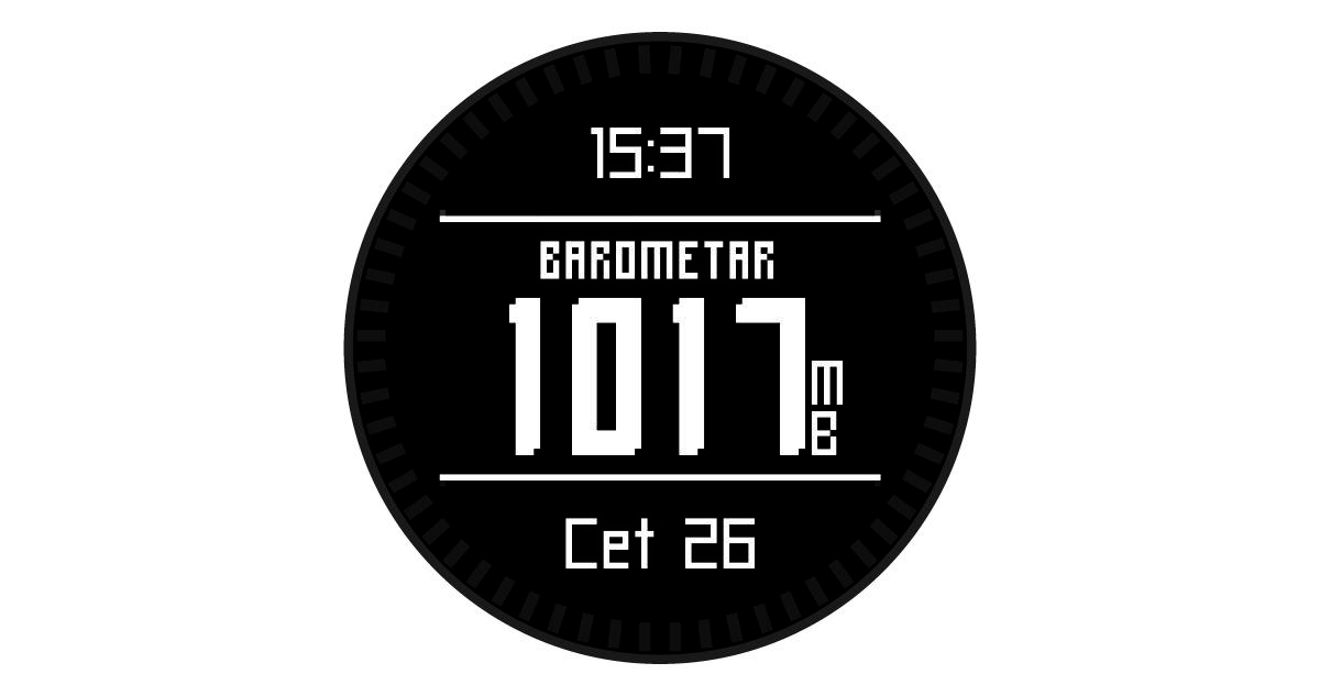

  3. Odaberite Down arrow.
    Screenshot of the barometer
