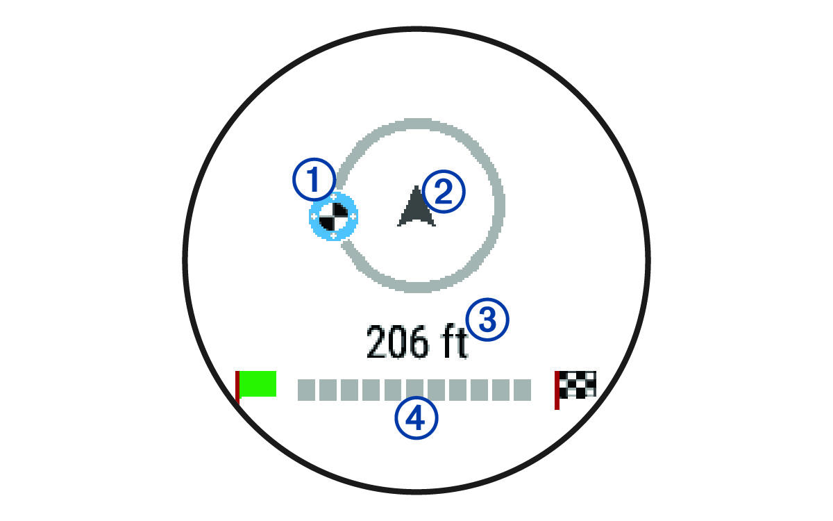

    Watch link app with callouts
    The destination indicator Callout number one shows the direction of your destination relative to the direction you are moving Callout number two. When the destination indicator appears at the top of the circle, you are heading toward your destination. The remaining distance to your destination Callout number three appears below the circle. The progress bar Callout number four shows your progress toward your destination.
