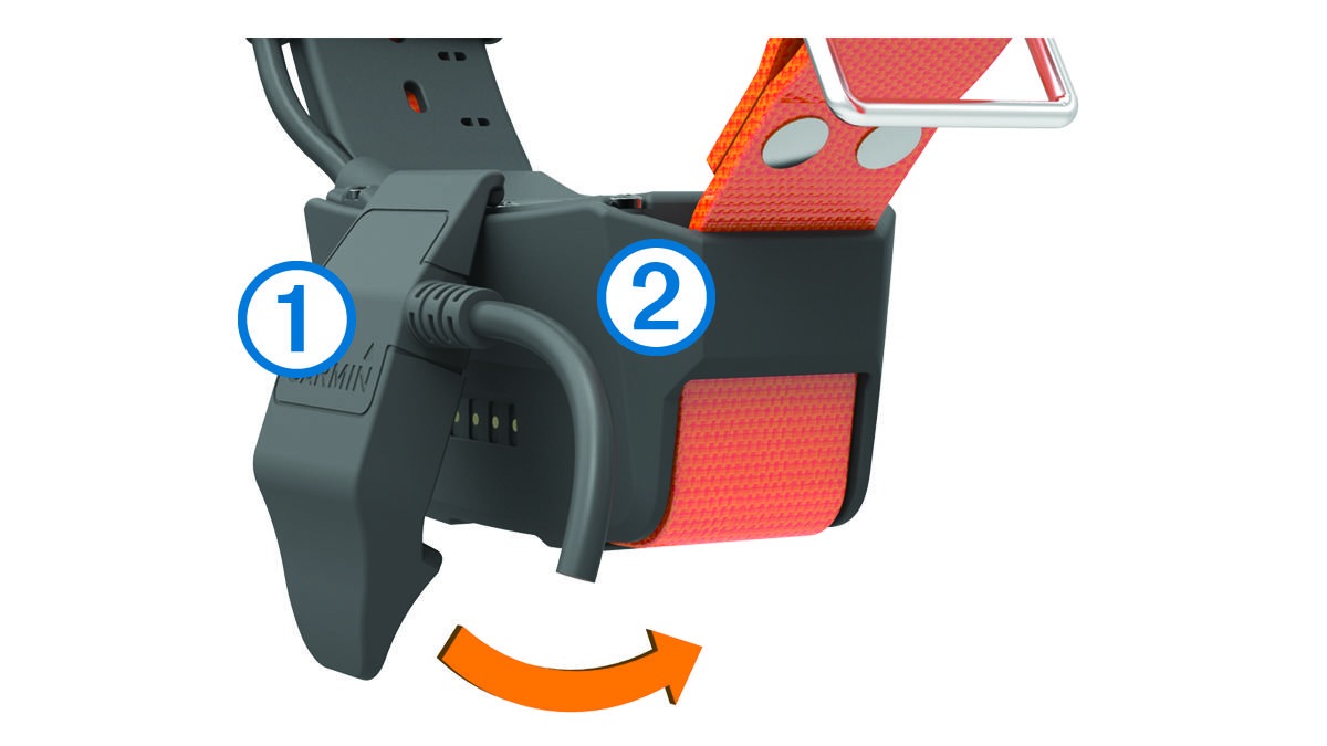

  1. Snap the charging clip Callout number one onto the device Callout number two.
    Charging clip attachment to dog device with callouts
