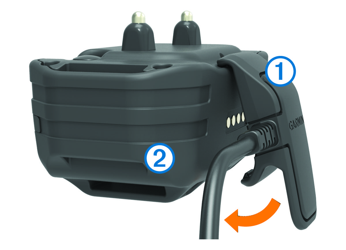

  1. Snap the charging clip Callout number one onto the device Callout number two.
    Charging clip in collar with callouts
  2. Plug the power cable into a power source.
    The status LED is solid red when the collar is charging.
  3. After the status LED turns solid green, remove the charging clip from the collar.
