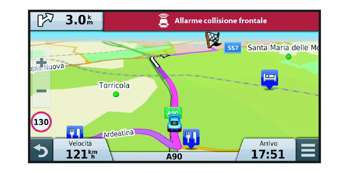

The FCWS feature alerts you when the device detects you are not maintaining a safe distance between your vehicle and the vehicle in front of you. The device determines your vehicle speed using GPS and calculates an estimated safe following distance based on your speed. The FCWS activates when your vehicle speed exceeds 48 km/hr (30 mph).
When the device detects you are too close to the vehicle ahead of you, the device plays an audible alert, and a warning appears at the top of the screen.
![Forward collision warning](../Shared/GUID-CF5AC568-5FBA-40A4-B33F-486F58EC213E-high.jpg)
