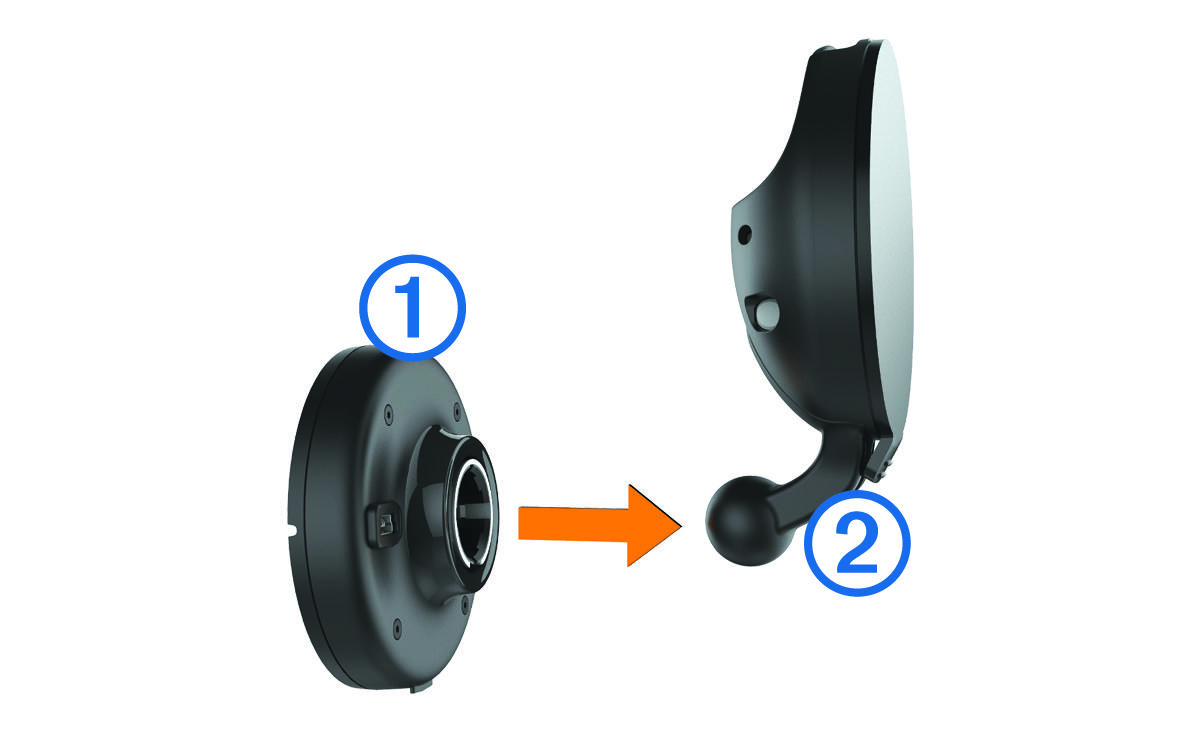

  1. Press the mount Callout number one onto the suction cup Callout number two until it snaps into place.
    Suction cup connecting to the mount with callouts

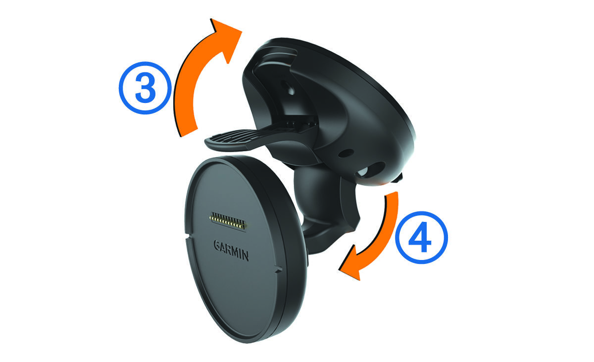

  2. Open the lever Callout number three, press the suction cup to the windshield, and flip the lever back toward the windshield.
    The lever must be oriented toward the top of the windshield.
    Device mounting to the windshield with callouts
  3. Extend the suction cup arm Callout number four.
  4. If necessary, rotate the mount so the Garmin® logo faces right-side up.

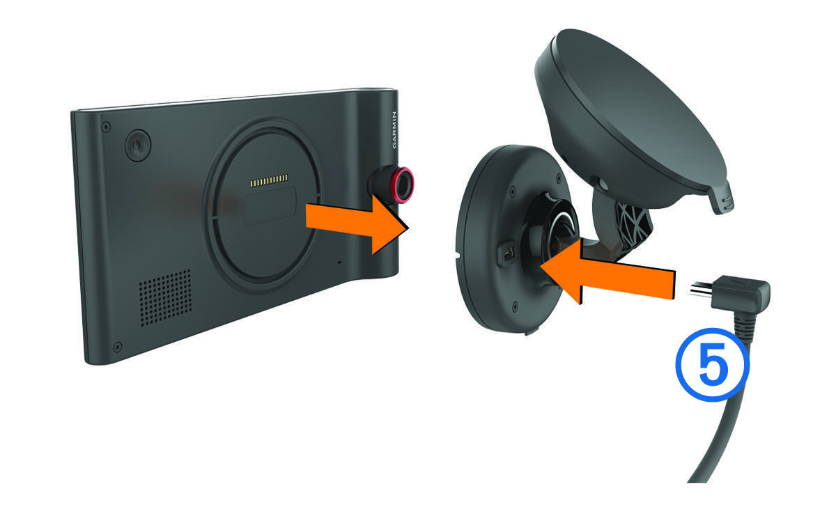

  5. Plug the vehicle power cable Callout number five into the port on the mount.
    Device connecting to the mount and power with a callout
  6. Place the back of the device onto the mount.
  7. Plug the other end of the vehicle power cable into a power outlet in your vehicle.
