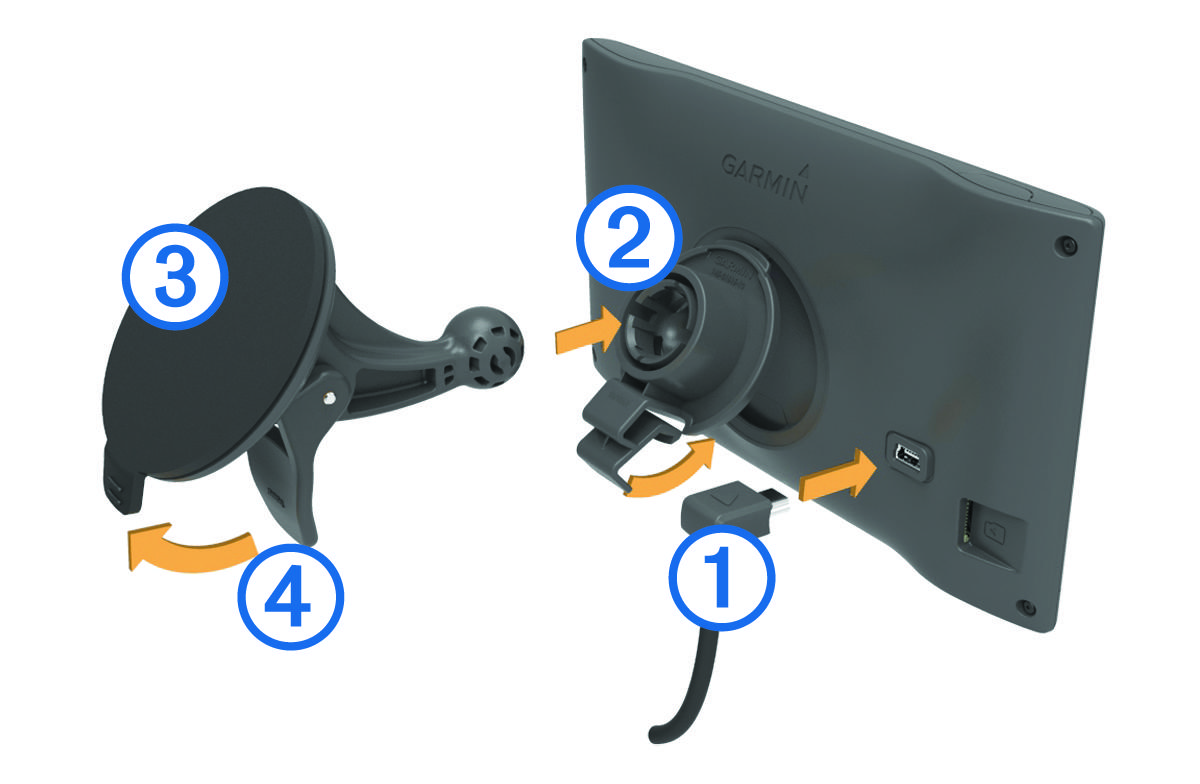

  1. Plug the vehicle power cable Callout number one into the USB port on the device.
    Device connecting to the mount and power with callouts
  2. Press the mount Callout number two onto the suction cup Callout number three until it snaps into place.
  3. Press the suction cup to the windshield, and flip the lever Callout number four back toward the windshield.
  4. Fit the tab on the top of the mount into the slot on the back of the device.
  5. Press the bottom of the mount into the device until it clicks.
  6. Plug the other end of the vehicle power cable into a power outlet in your vehicle.
