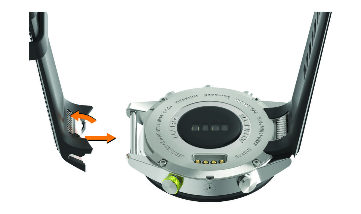

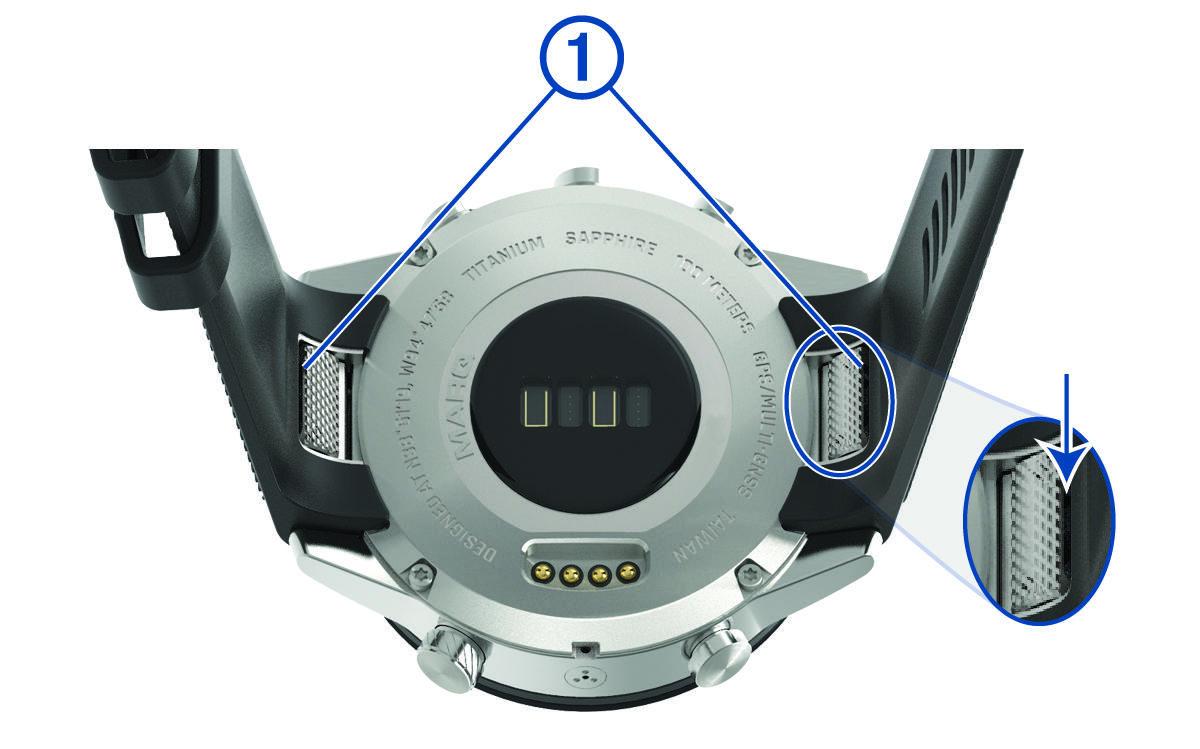

Changing Integrated QuickFit Accessories Pull to open the latch, and remove the integrated QuickFit® strap or bracelet from the watch. Pull to open the latch on the integrated strap or bracelet, and align it with the watch. Close the latch over the watch pin. NOTE: Make sure the strap or bracelet is secure. There should be a small gap between the latch and the strap or bracelet. Parent Topic: Device MaintenanceHomeDevice InformationDevice MaintenanceChanging Integrated QuickFit Accessories
