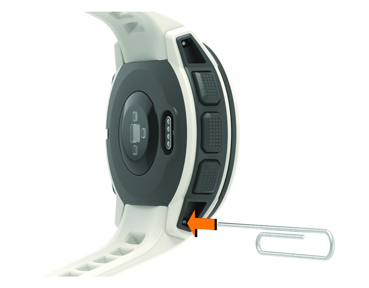

  1. Use a paper clip to push in the watch pin.

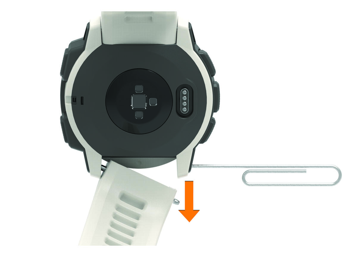

  2. Remove the band from the watch.
    Watch band removal

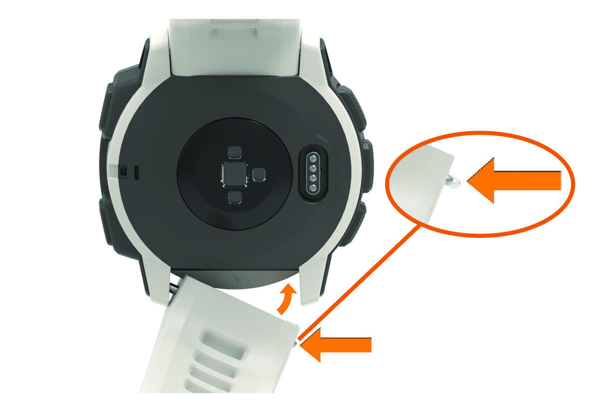

    • To install Instinct bands, align one side of the new band with the holes on the device, push in the exposed watch pin, and press the band into place.
      Watch band replacement
      NOTE: Make sure the band is secure. The watch pin should align with the holes on the device.

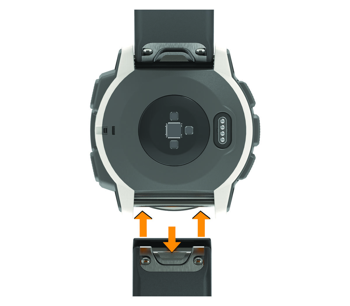

    • To install QuickFit 22 bands, remove the watch pin from the Instinct band, replace the watch pin on the device, and press the new band into place.
      Quickfit band replacement
      NOTE: Make sure the band is secure. The latch should close over the watch pin.
