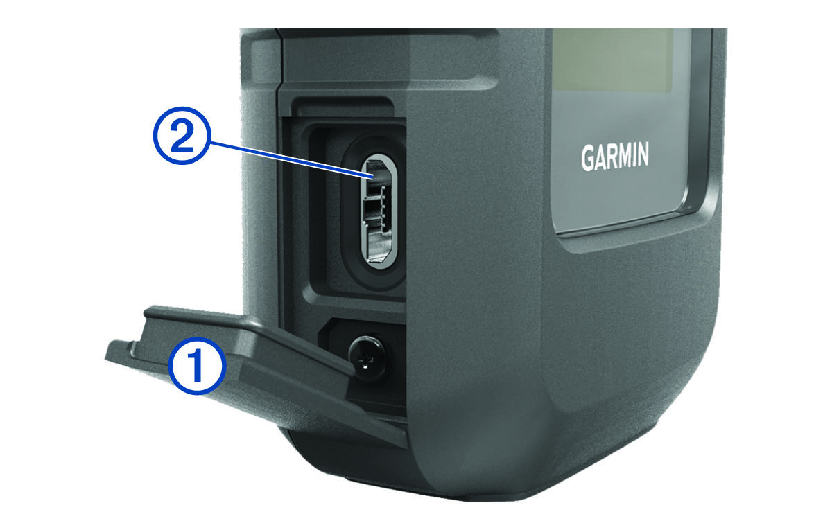

  1. Lift the weather cap 1.
    Close-up view of the charging port and weather cap with callouts
  2. Plug the small end of the power cable into the USB port 2 on the device.
  3. Plug the other end of the power cable into an appropriate power source.
