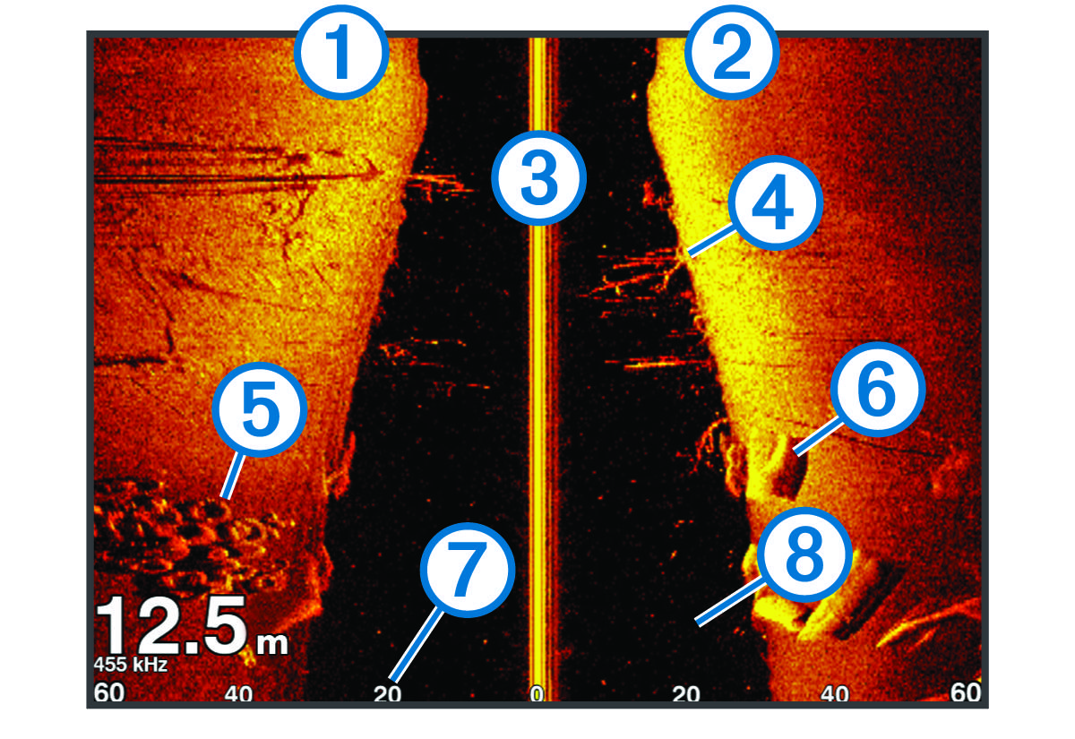

SideVü scanning sonar technology shows you a picture of what lies to the sides of the boat. You can use this as a search tool to find structures and fish.
![SideVü sonar view with callouts](../Shared/GUID-EB0F2443-89C4-4D87-A39C-B3534F59C176-high.jpg)
Left side of the boat |
Right side of the boat |
The transducer on your vessel |
Trees |
Old tires |
Logs |
Distance from the side of the boat |
Water between the vessel and the bottom |
