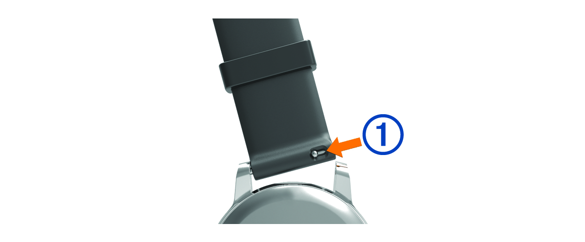

  1. Slide the quick-release pin Callout number one on the spring bar to remove the band.
    Watch band installation with a callout
  2. Insert one side of the spring bar for the new band into the device.
  3. Slide the quick-release pin, and align the spring bar with the opposite side of the device.
  4. Repeat steps 1 through 3 to replace the other band.
