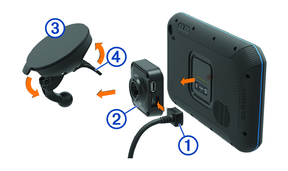

  1. Plug the vehicle power cable Callout number one into the mini-USB port on the mount.
    Device and mount assembly with callouts
  2. Press the mount Callout number two onto the suction cup Callout number three until it snaps into place.
    NOTE: The mount and suction cup may already be assembled in the package.
    The Garmin® logo on the mount should face right-side up. It is easiest to connect the mount and suction cup when the hinged arm on the suction cup is closed. The mount and suction cup fit tightly, and you may need to press hard to connect them.
  3. Press the suction cup to the windshield, and flip the lever Callout number four back toward the windshield.
  4. Place the back of the device onto the magnetic mount.
  5. Select an option:
    • If your power cable has a vehicle power plug, plug it into a power outlet in your vehicle.
    • If your power cable has bare wire connectors, follow the wiring diagram included with your cable to connect the cable to vehicle power.
