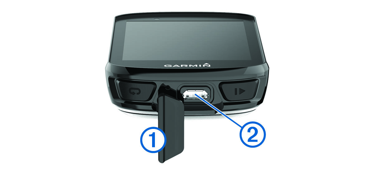

  1. Pull up the weather cap Callout number one from the USB port Callout number two.
    Bottom view of the device with callouts
  2. Plug the small end of the USB cable into the USB port on the device.
  3. Plug the large end of the USB cable into an AC adapter or a computer USB port.
  4. Plug the AC adapter into a standard wall outlet.
    When you connect the device to a power source, the device turns on.
  5. Charge the device completely.
After you charge the device, close the weather cap.
