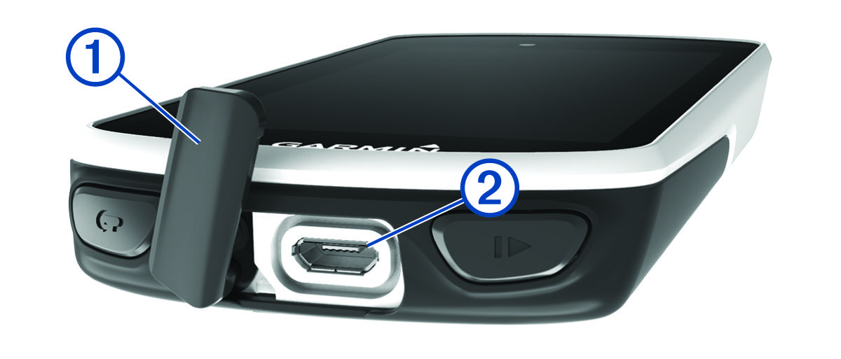

  1. Pull up the weather cap Callout number one from the USB port Callout number two.
    Bottom view of the device with callouts
  2. Plug the small end of the USB cable into the USB port on the device.
