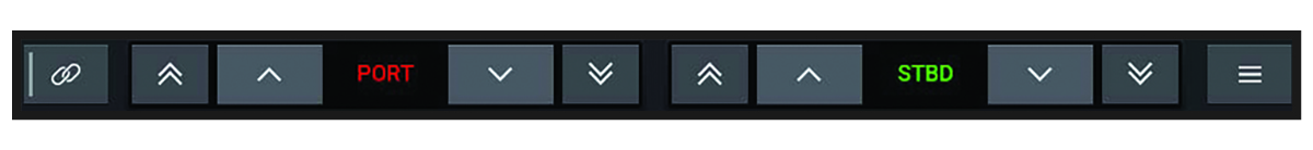

![Power-pole control bar](../Shared/GUID-BC5A6877-C28B-457A-8A76-2B914A79B765-high.jpg)
Select to control both anchors simultaneously Deselect to control the anchors independently |
Select to fully retract the anchor |
Select to fully extend the anchor |
Hold to retract the anchor manually Release to stop the anchor |
Hold to extend the anchor manually Release to stop the anchor |
Select to open the menu |
PORT |
Port side anchor control buttons |
STBD |
Starboard side anchor control buttons |
