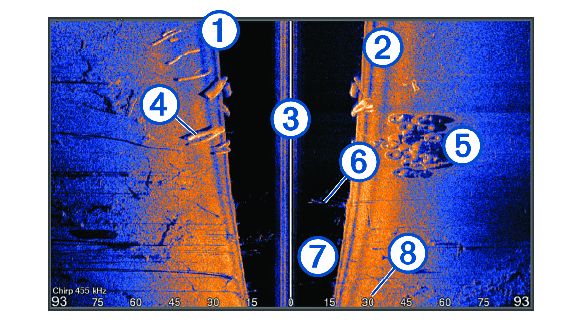

SideVü scanning sonar technology shows you a picture of what lies to the sides of the boat. You can use this as a search tool to find structures and fish.
SideVü sonar view with callouts
Callout number one
Left side of the boat
Callout number two
Right side of the boat
Callout number three
The transducer on your vessel
Callout number four
Logs
Callout number five
Old tires
Callout number six
Trees
Callout number seven
Water between the vessel and the bottom
Callout number eight
Distance from the side of the boat
