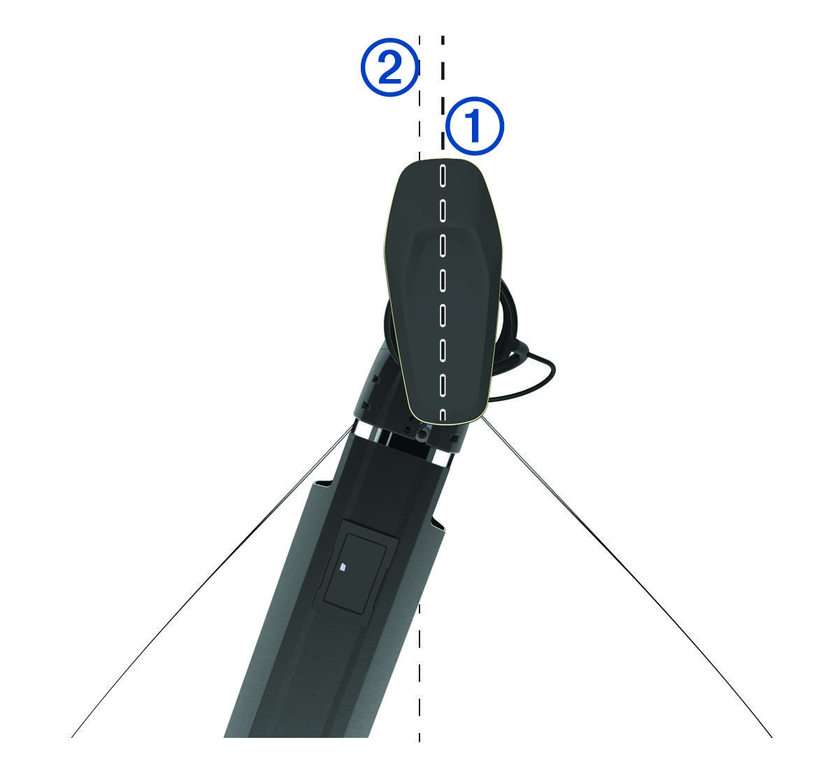

Based on the installation angle, the trolling motor may not align with the center line of your boat. For the best results, you should set the bow offset.
  1. Adjust the angle of the trolling motor Callout number one so it aligns with the center line of your boat Callout number two, pointing straight forward.
    Trolling motor bow offset
  2. From the trolling motor bar, select Menu symbol > Calibrate > Bow Offset.
