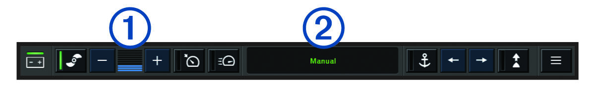

Trolling Motor Control Bar
The trolling motor control bar allows you to control a Force® trolling motor and see the status of the motor.
Select an item to engage it. The button illuminates when selected. Select the item again to disengage it.
Trolling motor bar with callouts
Battery status
Trolling motor battery status.
Propellor
Turns the propeller on and off.
Minus symbol
Reduces the speed.
Callout number one
Speed indicator.
Plus symbol
Increases the speed.
Cruise control
Enables the cruise control at the current speed over ground (SOG).
Full speed
Engages the propellor at full speed.
Callout number two
Trolling motor status.
Anchor lock
Enables anchor lock, which uses the trolling motor to hold your position.
Steer leftSteer right
Steers the trolling motor.
When in anchor lock, jogs the anchor lock position forward, backward, left, or right.
Heading hold
Enables heading hold (set and maintain the current heading).
When the trolling motor is in heading hold, an autopilot bar appears in the trolling motor bar.
Menu symbol
Opens the trolling motor settings.
