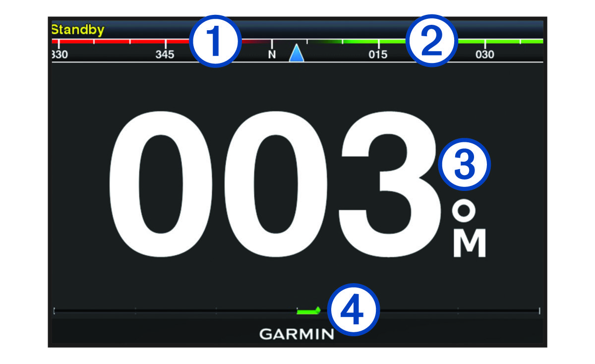

Autopilot Screen
Actual heading |
Intended heading (heading the autopilot is steering toward) |
Actual heading (when in standby mode) Intended heading (when engaged) |
Rudder position indicator (available when a rudder sensor is connected) |
Step turn to port (to adjust the intended heading by amount shown) |
Step turn to starboard (to adjust the intended heading by amount shown) |
