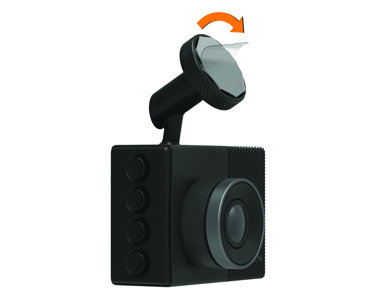

  2. Remove the protective film from the mount adhesive.
    Protective film peeled away from the mount adhesive

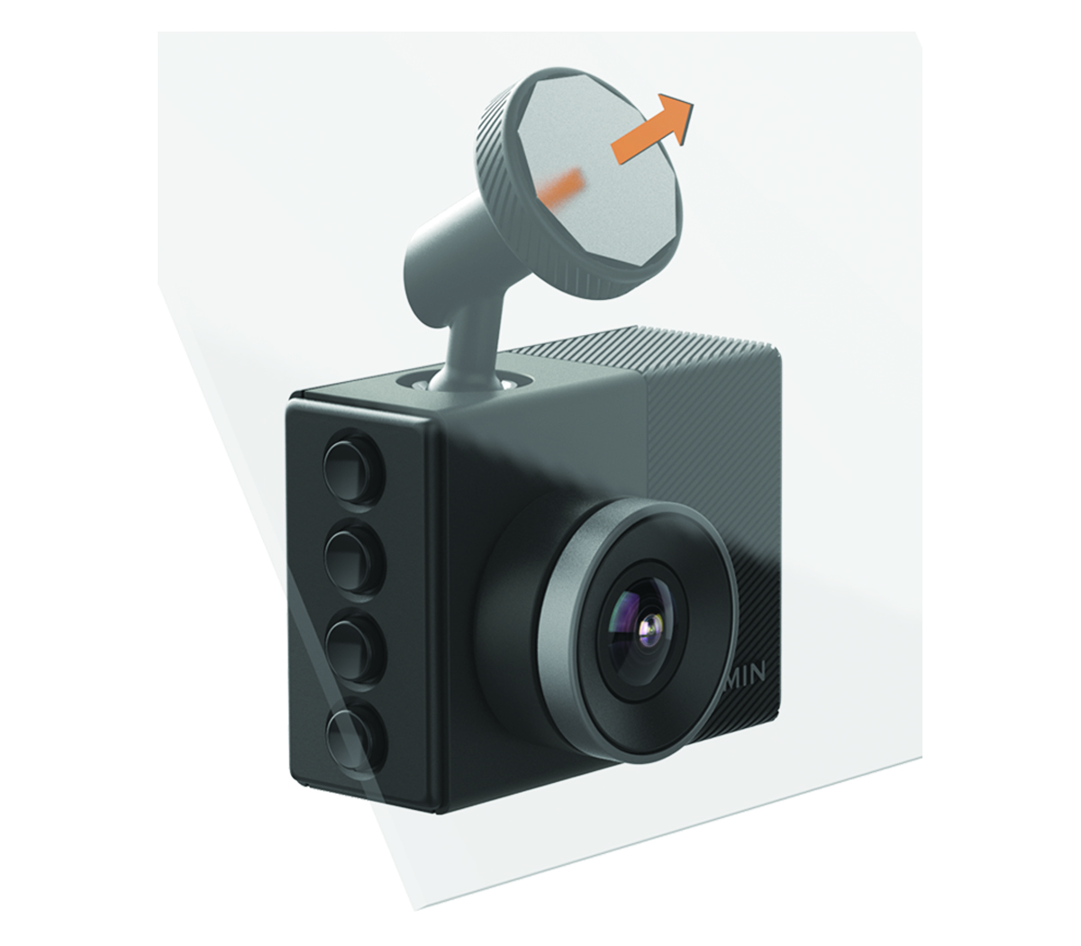

  3. Position the mount over the mounting location.
    TIP: The adhesive is extremely sticky. Avoid touching the adhesive to the windshield until the mount is properly positioned and aligned.
  4. Press the mount firmly onto the windshield, and maintain pressure for 30 seconds.
    This helps to ensure the mount adhesive has proper contact with the windshield.
    Camera and mount pressed onto a windshield
