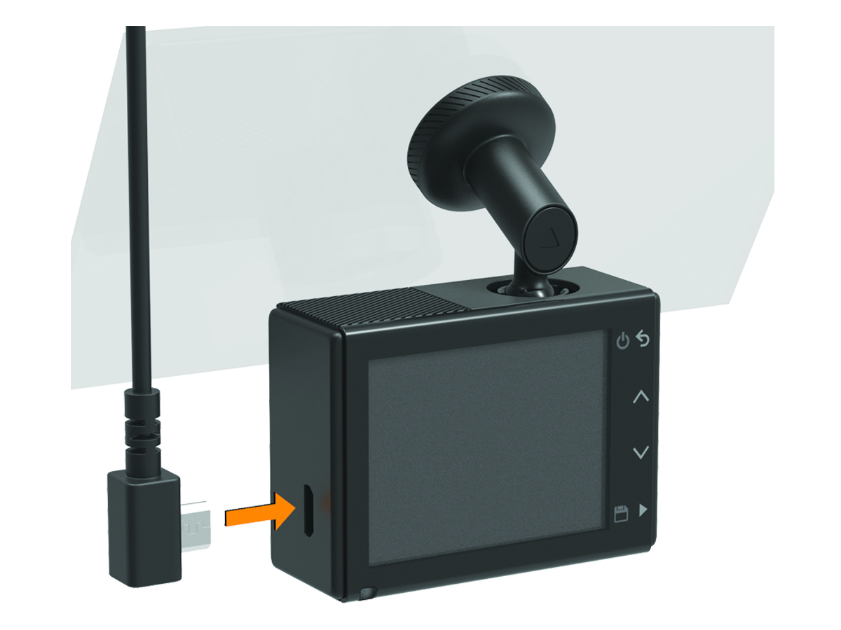

  1. Plug the power cable into the USB port on the device.
    Power cabled connection to the micro-USB port on the side of the camera

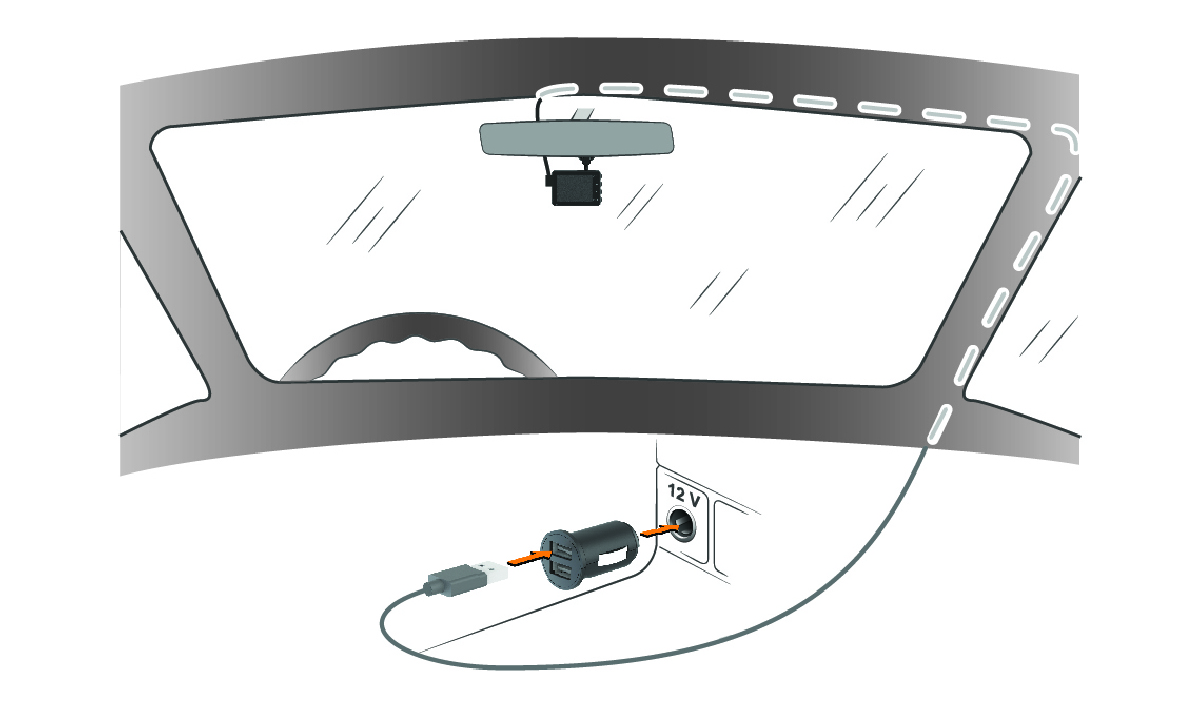

  2. Route the power cable to your vehicle power outlet.
    You can use either of the included cables to provide power to the camera. The longer, lightweight power cable is designed to be routed out of sight. To hide the 4 m (13 ft.) cable, route it behind the vehicle trim along the windshield, doorframe, or dash.
    Power cable routed around the windshield and dash and connected to vehicle power adapter
  3. Plug the Garmin Dash Cam™ power cable into the included power adapter.
  4. Plug the power adapter into a power outlet in your vehicle.
  5. If necessary, turn on the vehicle ignition switch to provide power to the power outlet in your vehicle.
