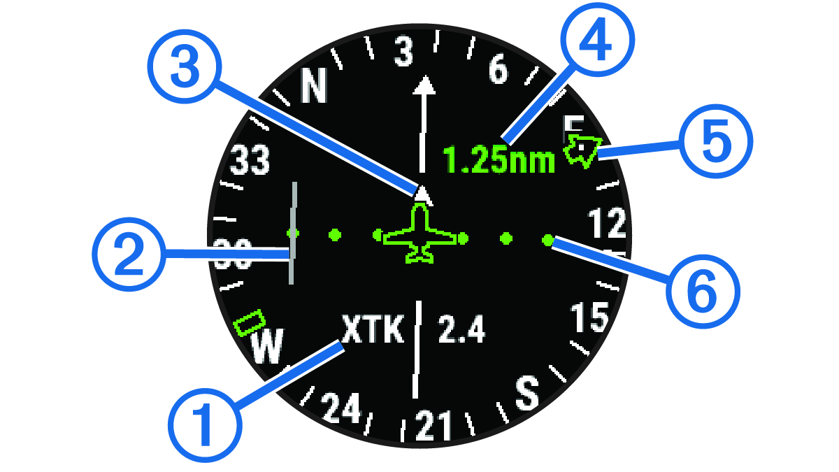

Horizontal Situation Indicator
Cross-track distance. |
Course deviation indicator (CDI). Indicates the location of the desired course line in relation to your location. |
To-and-from indicator. Indicates whether you are headed toward or away from the waypoint. |
Course deviation distance scale. |
Bearing to the nearest airport. |
Course deviation distance. The dots indicate your distance off course. |
