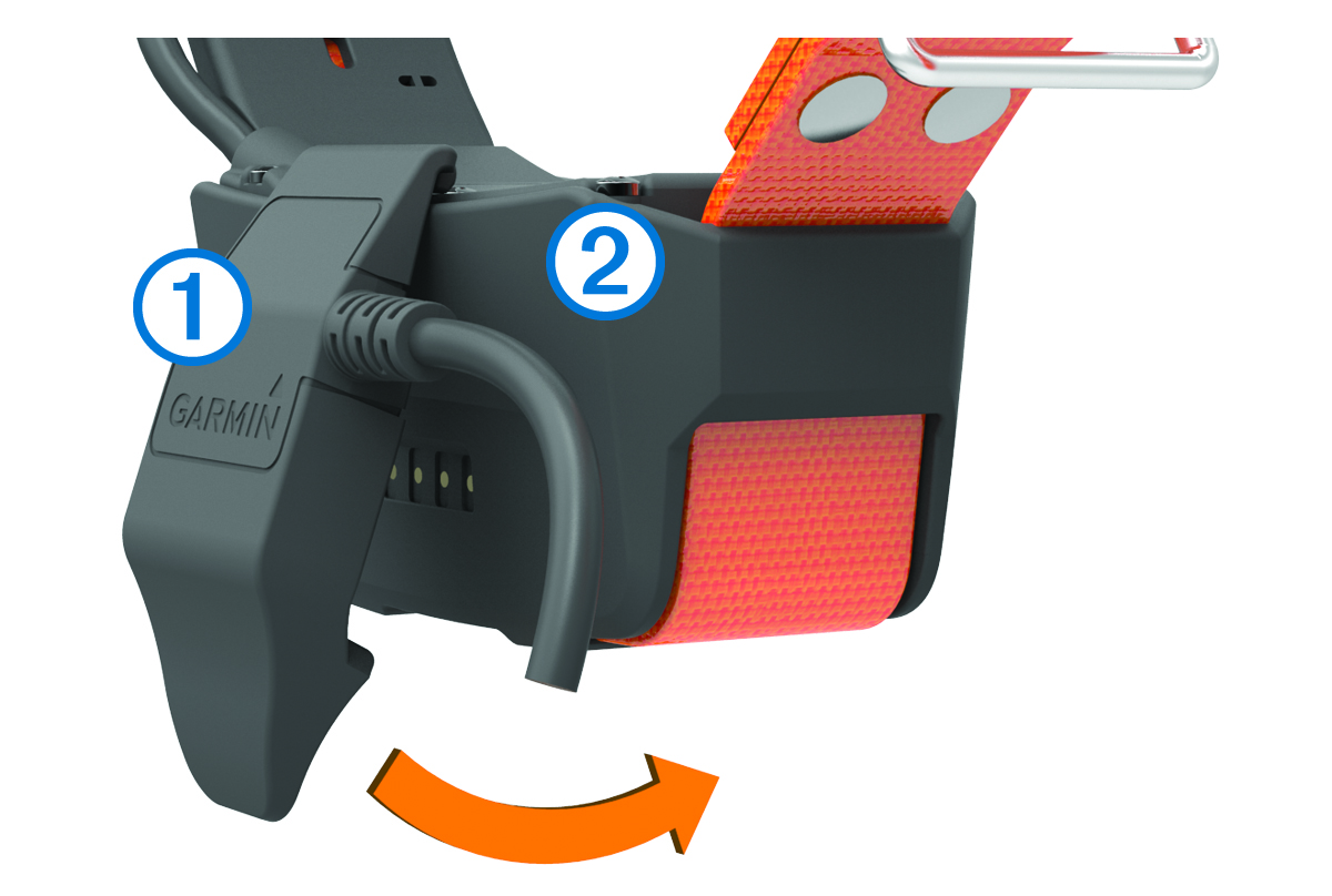

  1. Snap the charging clip Callout number one onto the device Callout number two.
    Close-up view of the charging clip attached to the dog collar device with callouts
