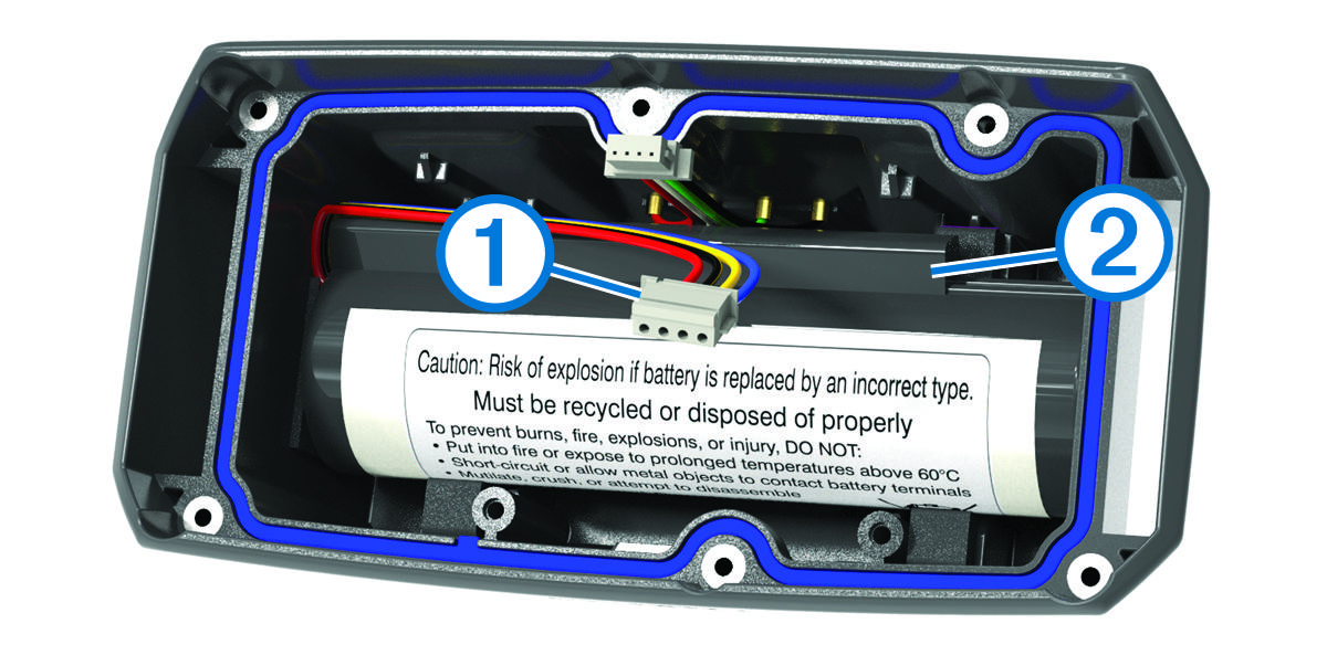

  1. Install the new battery using the same orientation as the old battery.
    The connector Callout number one should face the end nearest the power key, and the bump Callout number two where the wires connect to the battery should face toward the side with the charging clip contacts.
    Close-up view of the battery orientation for the dog collar device with callouts
