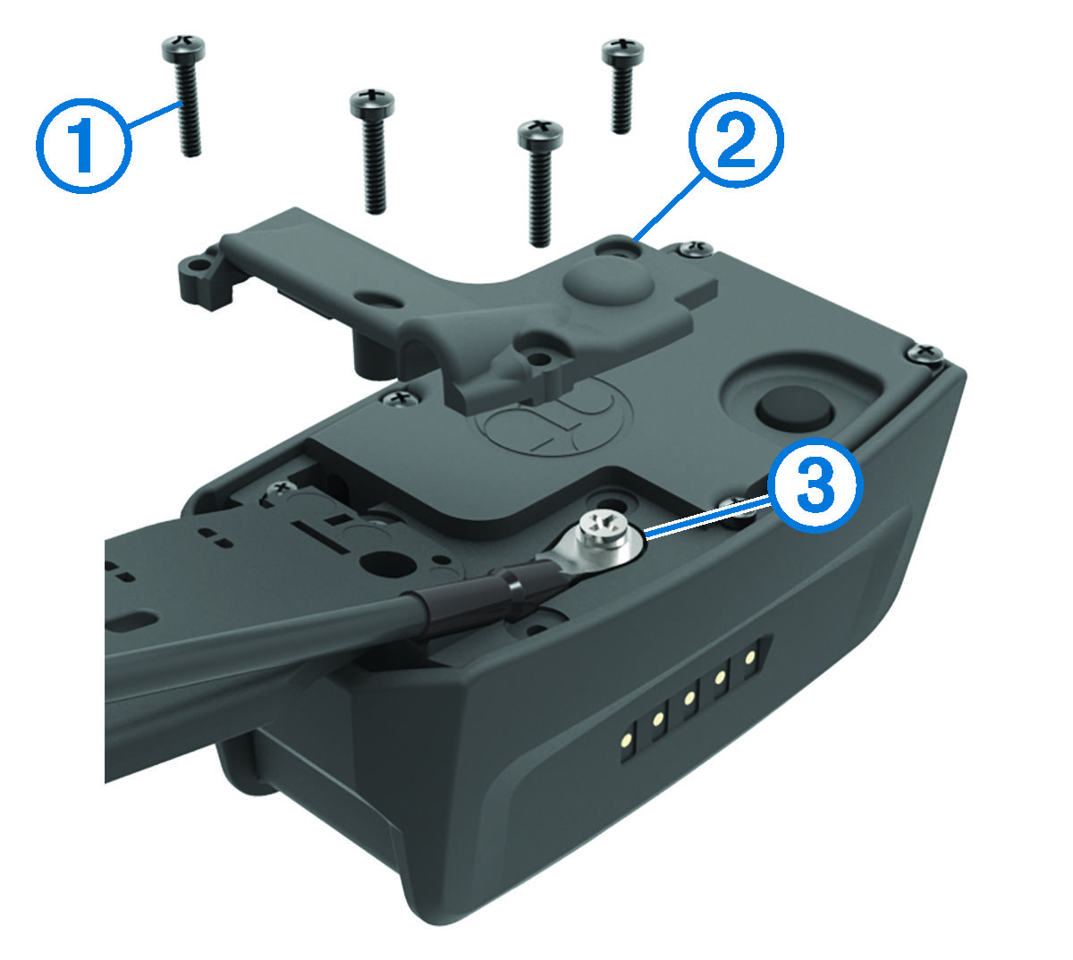

  1. Remove the 4 screws Callout number one from the cover over the VHF antenna.
    NOTE: You should note the location of the one short screw Callout number two.
    Exploded view of the VHF antenna cover with callouts
  2. Pry off the cover.
  3. Remove the screw Callout number three securing the VHF antenna to the back plate.
  4. Pull the length of the antenna from the antenna guide to remove the old antenna.
  5. Loop the antenna guide around the collar strap, and thread the new VHF antenna through the guide.
    This helps to point the antenna up.
  6. Replace the screw securing the VHF antenna to the back plate.
  7. Replace the cover over the VHF antenna.
  8. Replace the 4 screws on the cover, replacing the short screw in the correct location.
